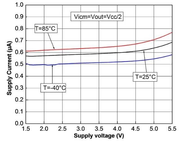

The TSU101 single operational amplifier offers an ultra-low power consumption of 580 nA typical and 750 nA maximum when supplied by 1.8 V. Combined with a supply voltage range of 1.5 V to 5.5 V, this feature allows the TSU101 to be efficiently supplied by a coin type Lithium battery or a regulated voltage in low-power applications.
