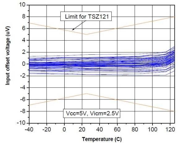

TSZ121 : Input offset voltage vs Temperature

■ Very high accuracy: Offset voltage 5 µV max at 25°C,
   8 µV over full temperature range (-40 to +125 °C)
