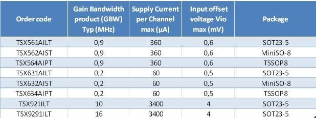

  • The TSX631/2/4 single, dual and quad amplifiers offer a 200 kHz gain bandwidth product while consuming 60 μA maximum at 16 V
  • The TSX561/2/4  single, dual and quad amplifiers offer an outstanding speed/power consumption ratio, 900 kHz gain bandwidth product while consuming only 250 μA at 16 V
  • The TSX921 and TSX9291 single amplifiers offer excellent AC characteristics, respectively 10 and 16 MHz gain bandwidth and 0.0003 % THD+N
