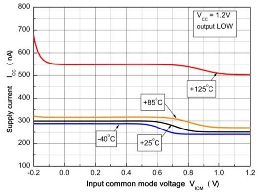

Current consumption VS Input common mode voltage TSS81 @Vcc = 1.2V
