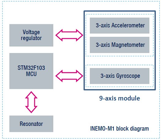

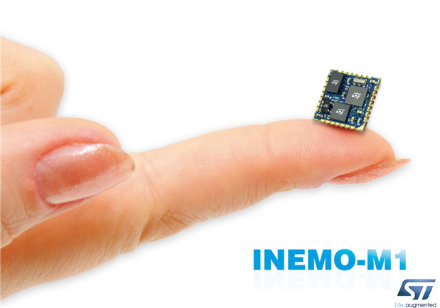

iNEMO-M1 is a 9-axis inertial system including ST MEMS sensors with a dedicated software that enhance its integration in embedded applications. It is the first member of System-On-Board family designed for cost-effectiveness and low consumption. Thanks to its wide set of communication peripherals and its extremely reduced dimensions, the iNEMO-M1 is ready to be used and can be directly integrated in a huge variety of advanced motion-based platforms in several application segments.
Features
·         9-axis + 32-bit MCU Module
·         3-axis digital gyroscope
·         6-axis geomagnetic module
·         STM32F103 MCU: WLCSP, ARM 32-bit cortex M3 CPU, 72 MHz,
512 Kbyte Flash, 64 Kbytes RAM
·         Ultra low drop-low noise voltage regulator
·         Flexible interfaces: CAN, USART, SPI and I2C serial interfaces, Full-speed USB 2.0
·         Compact Design: 13x13x2mm, 28 pins
·         Free ADC channels for external inputs
·         iNEMO SW Fusion library
