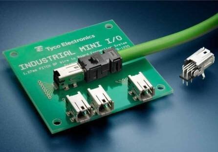

Industrial Mini I/O Connector System
The new Industrial Mini I/O connector system from Tyco Electronics features  two points of contact to maintain performance and increase reliability in high vibration environments. The compact connector, approximately one-fourth the size  of a traditional RJ-45 plug, includes a latching system designed to protect the  plug from pull-out during high vibration or collision.
Mini I/O meets  the stringent demands of industrial devices. The rigid  latching system and multiple contact points significantly reduce the risk  of information loss in a high vibration environment.  The connector system is an excellent replacement for existing RJ-45 technology.  It occupies significantly less space while offering increased functionality.
The polarized, wire-to-board interface features two keying options to prevent mismating and consists of eight individual circuits to accommodate I/O signals. Electrical specifications include a current rating of 0.5 Amps and a 30 Volt rating on 0.635mm centerline spacing.  The connector's operating temperature ranges from -40 to +70 degrees Celsius with a durability of 1500 cycles.  Products offered include SMT and through-hole configurations.
The product - suitable for industrial controllers, PLCs, motion control and robotics in the  industrial automation market - meets Cat5e requirements when used in Ethernet  applications.
