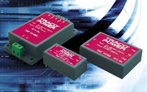

Encapsulated AC/DC Power Modules
TRACOPOWER launches with the TMP series a new generation of AC/DC power modules comprising of 62 models with power ranges from 7 W to 60 W. There are models available with single-, dual- and triple-output and voltage configurations from 3.3 to 48VDC.
The fully encapsulated modules are available for PCB-mounting with solder pins or for chassis mounting with screw terminal block.
In addition there is also an adaptor available for easy snap-on mounting on DIN-rails. This new series feature compact dimensions with a lower profile than other products in the market.
Universal input 85-264VAC and protection class ll qualify the power supplies for a wide range of applications in commercial or industrial equipment. The operating temperature range is specified for –25°C to +50°C without power derating. The high reliability of TMP series is documented with calculated MTBF figures from 250’000 to 330’000 h and backed by a 3 year product warranty.
