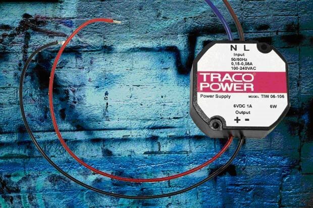

TIW-Series – Compact 6 & 12 Watt Power Supplies in IP67 Package
With the TIW series TRACOPOWER launches a new generation of AC/DC Power Supplies, mainly for building and office automation and for household installations and equipment.
The power supplies come in a dust and waterproof IP67 plastic housing, and are easy to connect via flying wires. With the compact design they fit into standard flush boxes for easy installation. The units can be operated in a temperature range of –25°C up to 50°C at full load an without forced cooling.
The series provides 6 Watt models with 3.3, 5.0 and 6.0 VDC and 12 Watt models with 12, 15 and 24 VDC fully regulated output voltages with continuous short circuit protection.
The input range is universal 93-264 VAC.They comply with the EMC emission standards EN 55022 Class B and EN 61000-6-3 for residential and office automation while they meet the immunity according EN 61000-6-2 for the industrial field. Protection Class II design and safety approvals to IEC/EN 60950-1, EN 50178, EN 60335-1 and others make this power supply the solution for a wide range of applications. All models are available for ex. stock deliveries.
