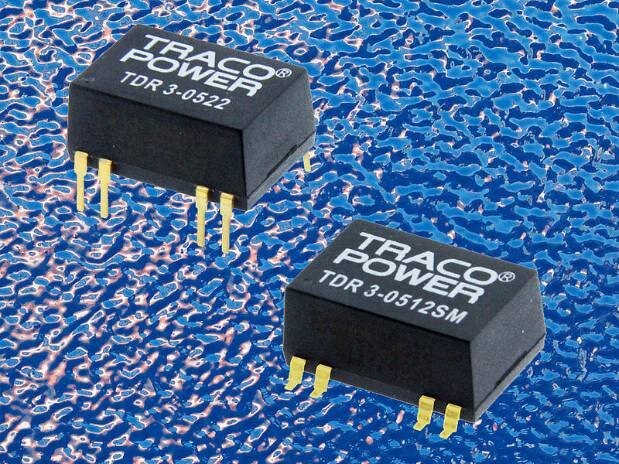

Fully regulated 2 to 3 Watt converters in ultra compact molded DIP or SMD package.
The series are available with 2:1 or 4:1 input voltage ranges covering 4.5 VDC up to 75 VDC. They work with high efficiency over the full load range with a tightly regulated output voltage even under no load conditions. With the dimension of 18.9 x 12.8 x 8.7, they use only about 50% board space compared to regular 2-3 Watt converters.
The package is hermetically sealed (molded) what makes the converters suitable for regular washing procedures. The SMD models are qualified for lead free reflow solder process according IPC J-STD-020D.
1500 VDC I/O-isolation, short circuit protection, remote On/Off, operating temperature range from –40°C up to 85°C and excellent immunity against environmental influences qualify the converters for high end applications.
They are the ideal solution for space critical applications in communication equipments, instrumentation and industrial electronics.
