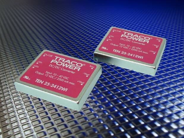

TRACOPOWER TEN 25WI Series with 4:1 Input Range
With TEN 25WI Series TRACOPOWER launches new high performance DC/DC converter modules to complete the 25 to 30 Watt power range with an ultra wide 4:1 input voltage range.
The products come in a low profile 50x40x10mm shielded metal package with industry standard footprint. Standard features include remote On/Off, output voltage trimming, over voltage protection, under voltage lockout, over temperature and short circuit protection.
Together with the input EMI filter to meet EN 55022, class A without the use of external components, these converters are easy to design in and suitable for a wide range of applications.
High efficiency up to 89% allows an extended operating temperature of –40°C to +85°C. Typical applications for these new converter modules are communication systems, industrial electronics, battery operated equipment and distributed power systems.
