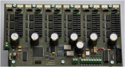

After two years, five PCB revisions, and other improvements to the FPGA, I finally settled on the VSRJ 0.01% resistor. Although 96 discrete resistors per channel are used, the signal path is actually very short, going through the 0.01% resistors, into a C-L-C filter, through a capacitor, and then into the potentiometer.
Fig. 1: Each channel uses 96 pieces of VPG Foil Resistors' VSRJ 0.01% Bulk Metal Foil resistors
Once the prototype worked as expected, I contacted VPG Foil Resistors Europe to choose the most appropriate Bulk Metal foil resistors. While the VAR series resistors – components specifically designed for audio applications – may have been the absolute ideal resistors to be used, the VSR series through-hole resistors offered sufficiently impressive performance combined with a preferred price tag. That is of particular interest due to the high number of resistors used per channel. To my knowledge, no other DAC for the high-end audio market uses a 24-bit foil ladder configuration. The Bulk Metal Foil resistive technology is the absolute key factor for the success of this design.
Fig. 2: The 3-way TOTALDAC board uses 288 of these resistors.

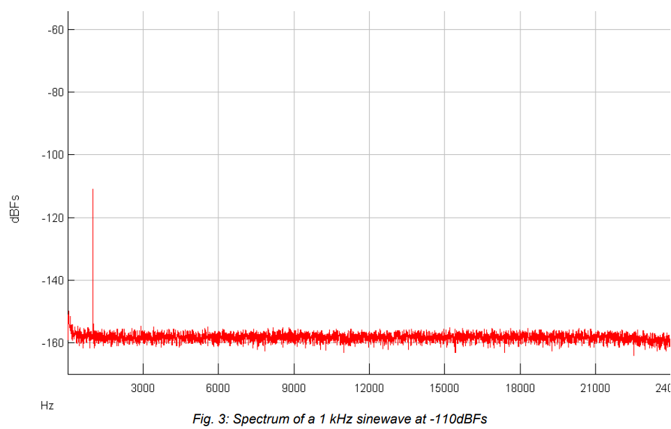

Measurements
Figure 3 shows the quality of the DAC for an extremely low amplitude signal such as concert hall long reverberation. The noise floor on graphic FFT is as low as -156 dB, although 0 dB is really the maximum DAC level (1.6 Vrms). The measurements were done by a Rohde & Schwarz UPL audio analyzer. Only the second order harmonic distortion is visible, and is only at -126dB. The distortion would be lower with an operational amplifier, but I preferred the sound created by discrete transistors without global feedback. Some noise is visible at low frequencies, it is due to the mains power supply. A power supply regulator would remove this noise but I prefer the sound without global feedback in the power supply for the analog section.
Fig. 3: Spectrum of a 1 kHz sinewave at -80dBFs with the power supply and buffer board
