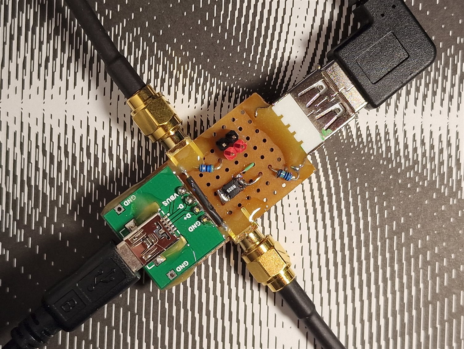

    shabaz over 3 years ago
    Hi James,
    Cute board! I too often want to power from a supply, and in the past have cut a USB cable to access the wires, which isn't great.
    It could also be interesting to add a resistor for current sensing, and either another couple of banana plugs for that, although then the board will get bigger. Maybe the connections for the current sensing could be just pin headers (if there will be an enclosure, then the pin headers could be pin sockets instead).
    Another option could be to have the banana plugs on wire ends, so that they can fit any PSU. If red/black cables are purchased and cut in half, then two of the adapters could be made (keep one, share one : ).
    I use this stripboard-assembled adapter, but instead of banana plugs, it has pin headers for connecting the supply (the red/black pin headers at the center of the image), which is non-ideal.
    Alternatively, it is possible to power from a USB supply or a PC, using the USB connector at the bottom-left of the photo (and remember not to plug in a power supply simultaneously! : ) A slide or toggle switch could be used to select between the options.
    I used two SMA connectors, one for the current, and one for monitoring the voltage. The data lines are passed through (not recommended on stripboard, but it was a short length). It was all quite fragile so lots of epoxy glue was used.
