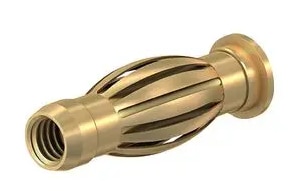

    The Staubli ones I liked are likely to be the threaded stud type -
    SA403/SA403N are M4 threaded studs. After using quite a few, I do prefer M4 studs for mechanical strength reasons, but I design my boards with dual-footprints so I can take M3 or M4.
    SA405/SA405N are the M3 thread version of the stud.
    SA404/SA404N are M3 contacts which seem to be threaded internally. This means you can screw an M3 screw into the back of them. They seem to be threaded through based on the element14 image of them -
    from https://au.element14.com/staubli/22-1054/plug-50a-gold-plated-screw/dp/1085561
    I would assume the Multicomp Pro versions (MP770525/MP770526) to be copies of the design, but there's not much information about the length of screw it will accept (i.e. is it threaded through or just part-way) as there are no end-on shots of the connector. But it will probably be a lot neater to have a screw head on the PCB rather than a long threaded bolt hanging out ...

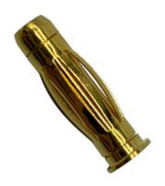

    Why doesn't the @baldengineer just use a vertical USB-A socket and get rid of all the mouse-bite, soldering complexity. It's not going to break the bank to use something like this: https://au.element14.com/gct-global-connector-technology/usb1040-gf-l-b/usb-conn-2-0-type-a-rcpt-4p-th/dp/3873308
    Have that vertically in-between your threaded banana contacts (https://au.element14.com/multicomp-pro/mp770525/conn-banana-plug-50a/dp/3514774) connected by an M3 screw (no idea of length - the drawing's pretty bad) or live with some "protruding" studs like you already have and you'd be as compact and cheap as can be?

    How familiar are you (or anyone) with this style: https://au.element14.com/multicomp-pro/mp770525/conn-banana-plug-50a/dp/3514774
    Looking at the Staubli products, these appear to be a screw cap? So, can I just "screw" them onto a m3 (or m4) screw??
