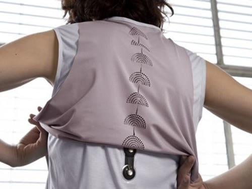

  1. Motion-tracking sportswear by Niraxx,
  2. MYSA Relaxation Shirt to monitor and relieve stress symptoms

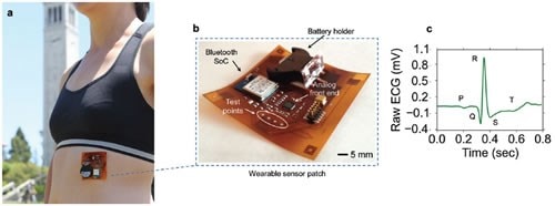

  3. Wearable ECG sensor [1]

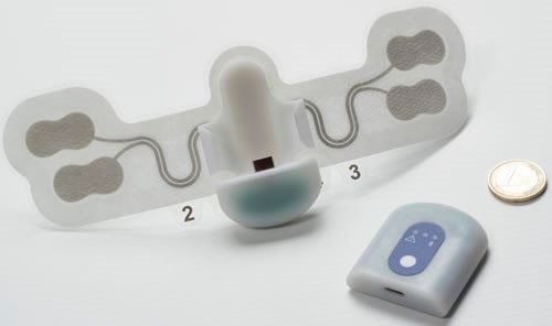

  4. Health patch for cardiac, lung or bowel conditions [2]
Figure 1: The MYSA shirt with vibration motors that provide haptic feedback [3]
Figure 2: Wearable ECG sensor [1]
Figure 3: Health patch for cardiac, lung or bowel conditions [2]

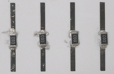

In one case study [4], the authors compare performances of several conductive adhesives in terms of resistance offered and adhesion strength. Table 1 shows the list of adhesives evaluated. For experimental purpose, a 300-μm thick Canon paper PT-101 substrate was selected. Nano particle Silver ink was used to print circuit traces. Test patterns are two 0.7 cm long and 0.1 cm wide lines with a spacing of 0.1 cm in between.
For the evaluation of resistance between components and printed tracks, 0 Ω SMD resistors (package 1206) were mounted on the silver traces using all four adhesives. It is important to mention here that during soldering, the solder tip never touched the temperature-sensitive silver ink. Figure 4 best depicts the experimental setup. The samples using Conductive Silver epoxy were passed through convection oven (90 oC) for 20 minutes in order to harden the glue.

Figure 4: 0 ohm resistors mounted on silver lines using four types of adhesives [4]
To calculate the average contact resistance, 10 resistors with four types of conductive adhesives were attached to silver traces. To evaluate adhesion strength, the resistors were pulled up and the resulting force was measured until they came off the substrate. Table 2 summarizes the results of both tests.
It is evident that Chemtronics’ manufactured Silver Epoxy Glue (CW2400) offers the least contact resistance, whereas in terms of pull strength silver epoxy lies in second place. Solder joints offer the highest pull strength of 23 N.
