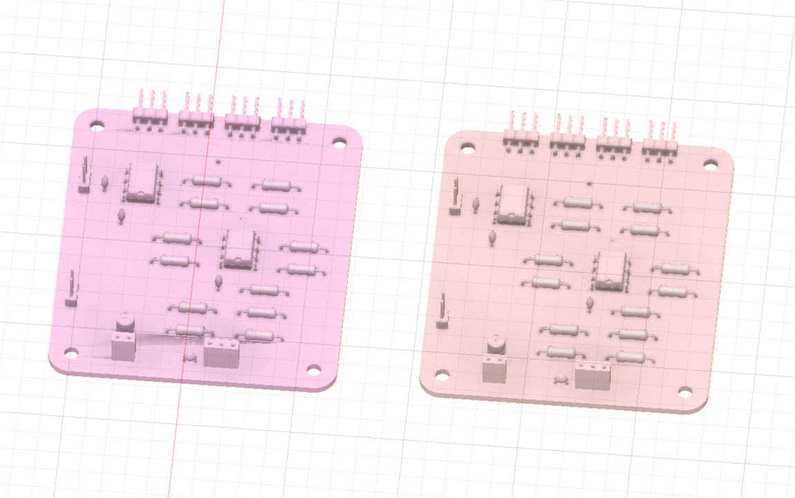

I usually work in millimeters but note that Fusion 360 can match whatever units you are using. STL and OBJ models do not retain color but are dimensionally correct after importing.  There isn't much to choose between them as shown in the screenshot below (STL is on the left, OBJ is on the right).  Both are easy and fast to manipulate inside Fusion 360 (but ugly!).
