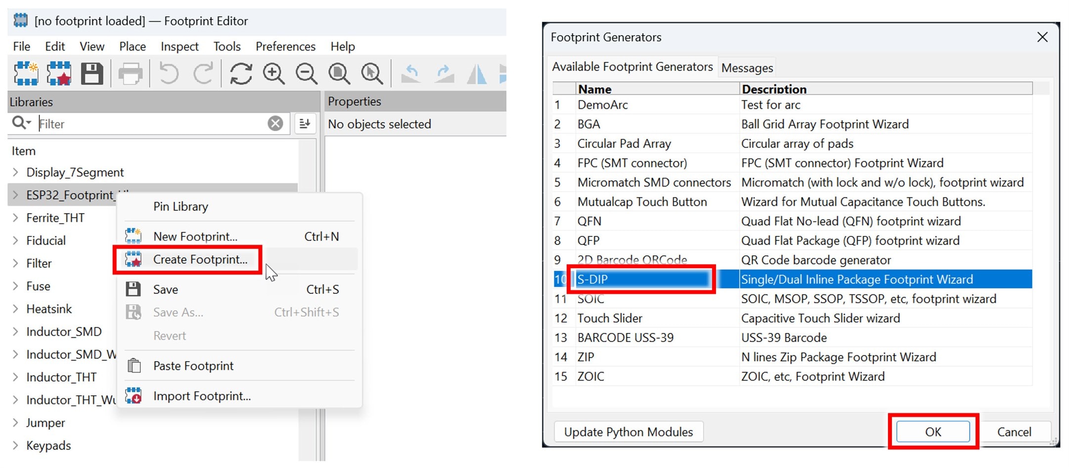

In the left pane, select your new library, and right-click on it. You’ll see a New Footprint menu option, but ignore that, and instead, select the next one, which is Create Footprint. The difference is, that New Footprint supplies a blank footprint drawing canvas, whereas Create Footrpint invokes a Footprint Generators wizard which will speed up the footprint creation.
Take a look at the wizard options, and select the most relevant one, which will be S-DIP, which is intended for Single-Inline or Dual-Inline Packages.

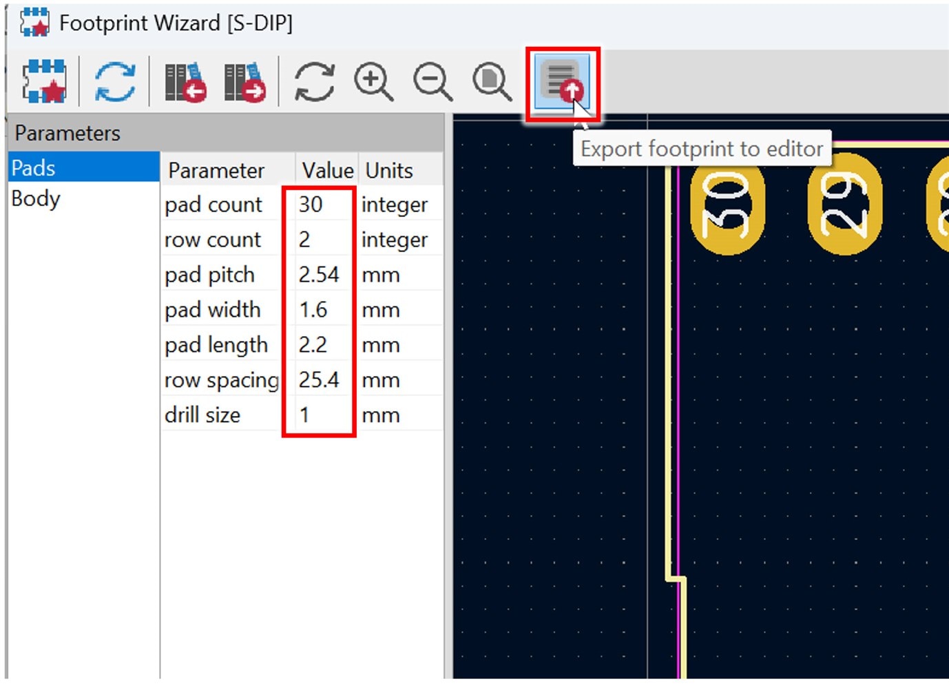

In the Footprint Wizard that was invoked as discussed above, you’ll see some categories (such as Pads and Body) on the left side, and then a load of parameters and their settings to the right of that. Work your way through that, modifying things to suit the component dimensioned drawing as best as possible.
The Pads category for the S-DIP wizard is the most important. The Body category for S-DIP defines the silkscreen outline, and it’s not ideal, so I decided to let the Wizard do whatever it likes with the outline, and I can delete or edit that later.
For the example ESP32 board, I populated the Pads category as shown in the screenshot below, and then clicked the Export footprint to editor icon.
You’ll notice that the Wizard created the footprint with an unwanted name. Right-click on it, select Rename Footprint and give it a better name. With some versions of KiCad, there is the risk of accidentally overwriting old footprints you’ve created with new ones, so it’s important to always rename to something different to what the Wizard named it as.

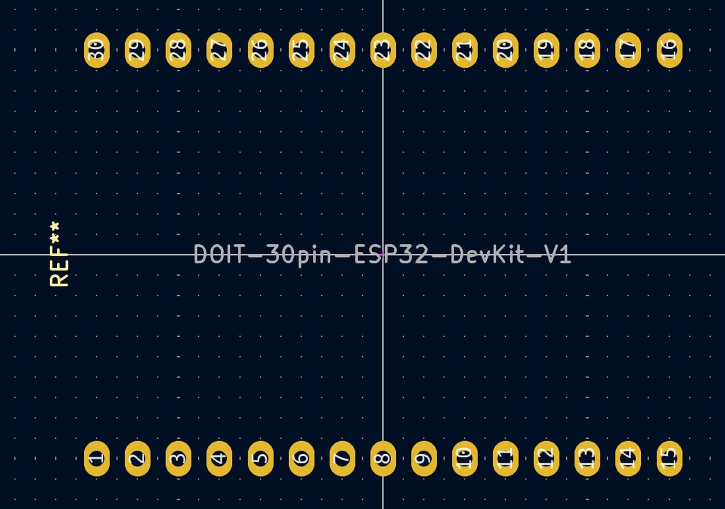

By default, the Wizard has laid out the pads to suit a typical DIP integrated circuit with pin 1 at the bottom-left. If that doesn't reflect the component you’re using, then the pads may need moving. In my case, it was easier if Pin 1 was at top-right to match the diagram that I had. It was easy to match that, by again clicking on All Items in the selection filter to deselect all, then selecting only Pads in the filter, then dragging to draw a shaded blue box over everything, then pressing R for Rotate twice. The result looked as shown here.

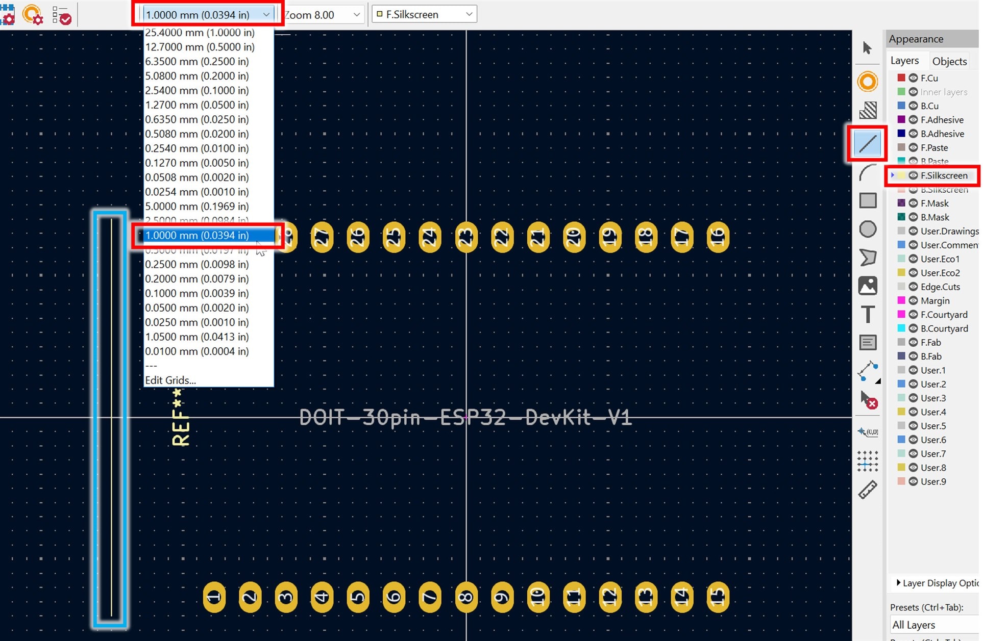

Next, roughly sketch one of the vertical silkscreen lines. To do that, first select a suitable grid (such as 1 mm), and select the F.Silkscreen (front silkscreen) layer from the right side pane, and select the Draw Line tool.
Click in the canvas once to set the starting point of the line, then move to the end point, and click again. Then, press Escape to stop the current line, and then press Escape a second time to quit the Draw Line tool.
You now have a line that is roughly in the desired position, but it needs to be made accurate as discussed next.

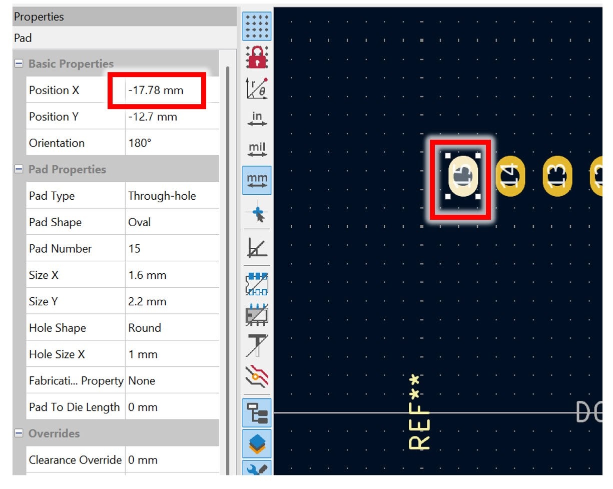

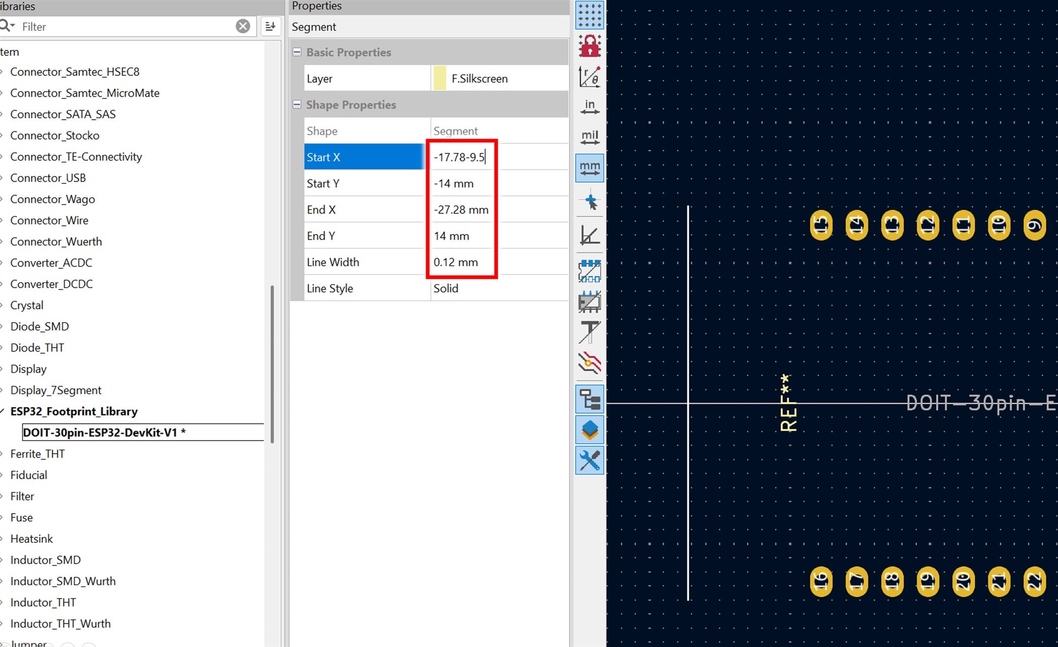

From the original component drawing, you can see that the line needs to be 28mm long and positioned 9.5mm to the left of the leftmost pads. Click on one of the leftmost pads, and see what its x-coordinate value is; you can read it off in the Properties pane on the left side of the canvas. If you don’t see any Properties pane, then you’ll need to enable it by clicking on View->Show Properties Manager.
As you can see in the screenshot below, the x-coordinate of the leftmost pad is -17.78mm.
Next, either single-click on the silkscreen line that you drew and then edit the values in the Properties pane, or, alternatively, double-click on the line and set the properties in the pop-up window.
For the x-coordinates, you can type -17.78-9.5 and KiCad will automatically perform the calculation.
Since the line is symmetric about the x-axis, the y-coordinates were set to -14 and 14mm, since that’s a length of 28mm.
I made a mental note that the left silkscreen line now had an x-coordinate value of -27.28, because that’s needed for calculating the following part.

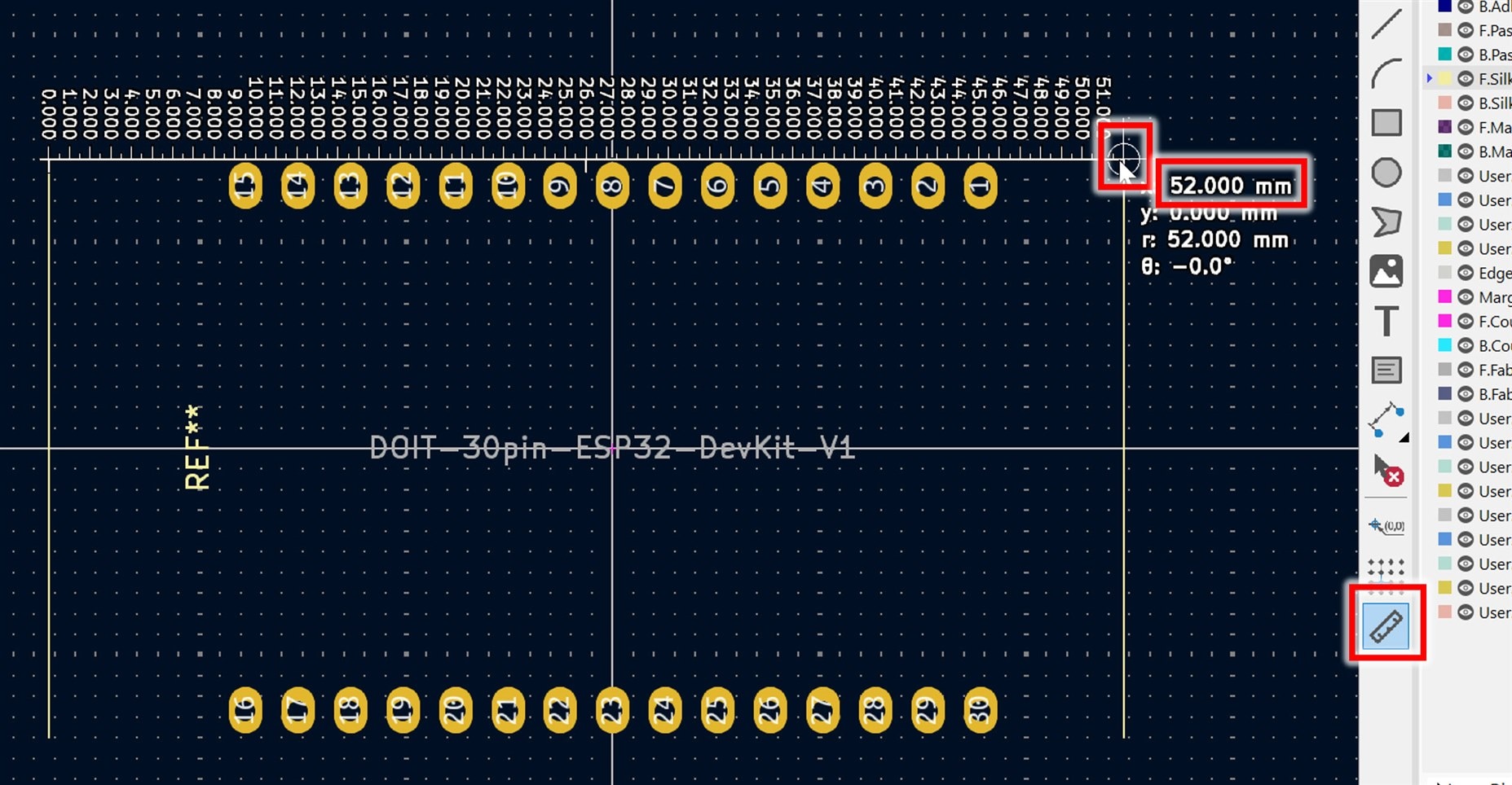

Next, I roughly drew the rightmost silkscreen line and then edited it such that the x-coordinate was -27.28+52, since the entire component has a dimension of 52mm.
You can check that things are correct by using the Measure tool in the palette on the right side of the canvas. Select it, then hover your mouse over one end of a line, and the cursor will turn into a circle with cross-hairs when it has snapped to the line endpoint geometry. Click with the mouse, then hover the mouse at the other line endpoint, and again you’ll see a circle with cross-hairs. You can read off the desired measurement to confirm that the two lines are spaced by 52mm.

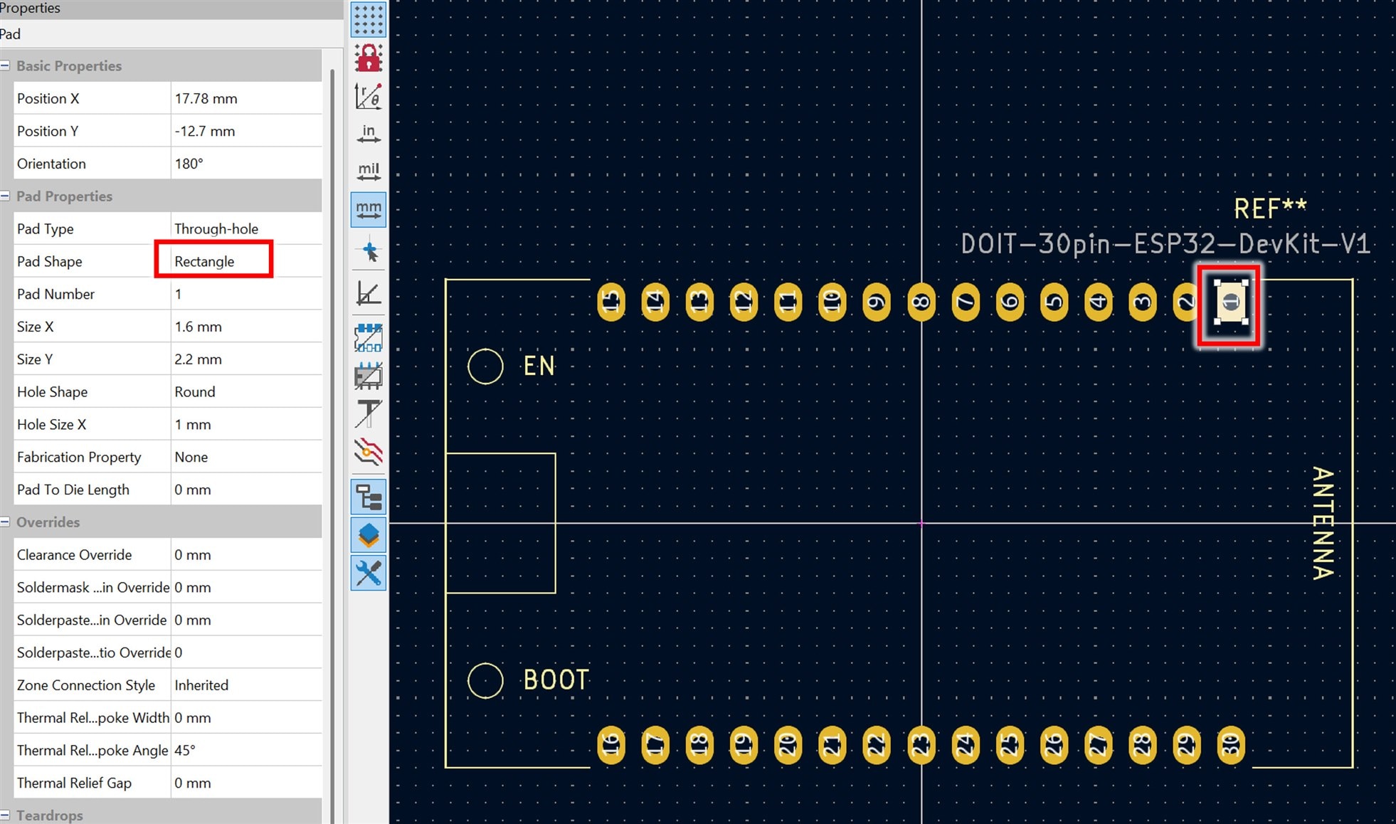

I used the Add Text tool and the Draw Circle tool in the example here. Also, since it is customary to set pin 1 to be a different shape pad, I clicked on that pad once, and then changed the Pad Shape attribute in the Properties pane, to Rectangle.

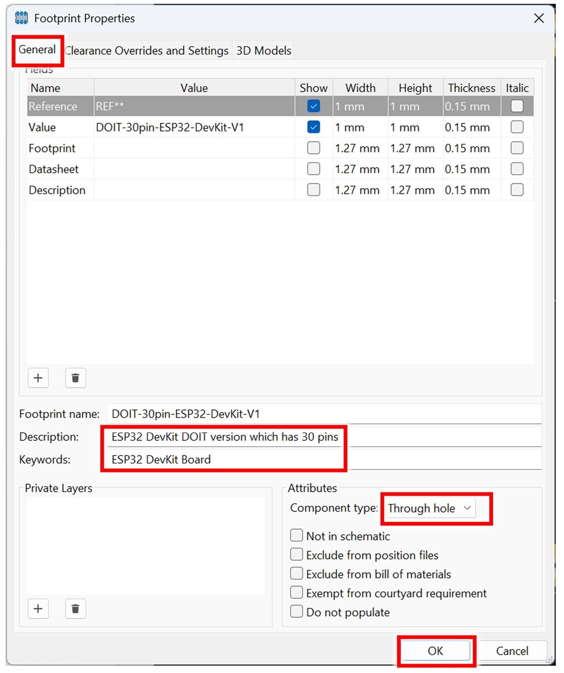

Click on File-> Footprint Properties and populate what you can. The screenshot here shows what I normally populate at a minimum.
At this stage, you are pretty much done with the component footprint! Press Ctrl-S to save it, although you should have been doing that periodically, just in case the software or the PC crashes.

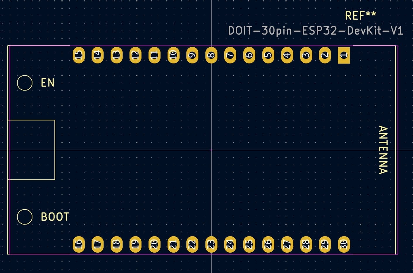

I found an ESP32 board 3D model on the Internet, and while it is not an exact match for the ‘DOIT’ brand ESP32 board, it was good enough, and it showed me that I should enlarge the silkscreen outline slightly, which I did.
Now I’m fairly confident the footprint would be suitable.
