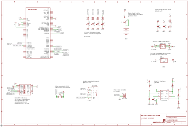

   To begin with, the software used to design the PCB was EAGLE. A new project was created and a third-party was added which would allow the use of the desired components. To continue, a schematic was created where components were connected together. The wiring tool which was used was the ratsnest. This tool is very useful when designing a PCB because it provides a visual feedback in the board design of the connections that should be routed. The drawn schematic is shown in the figure below:
It is noticeable that components are connected through labels instead of wires. This is a convenient function of EAGLE to maintain the schematic well structured and easily readable. Finally, an electrical rule check is applied to check for errors between connections.
