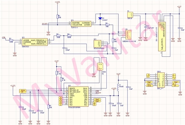

Circuit Analysis [mainboard]
Figure-1 shows the schematic diagram of the mainboard. The power and digital circuits are on one board.
Figure 1
Schematic diagram of the AC Dimmer’s mainboard
IC1, D1, and R2 are used to detect zero-crossing points. The zero-crossing points are quite essential for an AC dimmer. IC1 [1] is an optocoupler that provides galvanic isolation. R1 is a pullup resistor that reduces the noise and allows us to capture all changes (both rising and falling edges).
IC3 is a 25A rated Triac from ST [2]. This high current rating allows us to easily reach 4000W dimming power, however, the temperature of the Triac must be kept low and as close to the room’s temperature. If you intend to control high power loads, don’t forget to mount a big heatsink or use a Fan to cool down the component. According to the datasheet, this Triac can be used in a variety of applications: “Applications include the ON/OFF function in applications such as static relays, heating regulation, induction motor starting circuits, etc., or for phase control operation in light dimmers, motor speed controllers, and similar”.
C3 and R6, R4 and C4 are snubbers. In a simple term, Snubber circuits are used to reduce the noise, however for more reading, please consider the AN437 application note from ST [3]. IC3 is a snubber-less Triac, however, I decided to use external snubber circuits as well.
IC2 is an optoisolator Triac [4] that is used to control the IC3. It also makes proper galvanic isolation. R5 limits the diode current of the IC2.
IC4 is the famous AMS1117 3.3V voltage regulator [5] that provides the power for the digital part circuits. C1 reduces the input noise and C2 reduces the output noise. P1 is a 2 pins male XH connector that is used to connect the external power to the device. Any input voltage from 5V to 9V is enough.
IC5 is the STM32F030F4 microcontroller and the heart of the circuit [6]. It provides all instructions to control the load. P2 is a 2*2 male header that provides an interface to program the microcontroller through the SWD.
R7 and R8 are pullup resistors for the pushbuttons. Therefore the pushbutton input pins of the MCU are programmed as active-low. C8, C9, and C10 are used to reduce the noise according to the MCU’s datasheet. L1, C5, C6, and C7 reduce the supply noise, also build a first order LC filter (Pi) to provide stronger filtering for the input noise.
IDC1 is a 2*7 (14 pins) male IDC connector that is used to make a proper connection between the mainboard and the panel board through a 14-way flat cable.
