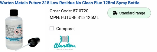

    Once the paste has all been melted apply a lot of really runny flux (I use Warburtons 315))
    You can get this from Rapid Electronics.
    Touch up the solder on the outer pads to solder any that are not and remove bridges. If there is too much solder remove some with solder wick. Keep it fluxy !
