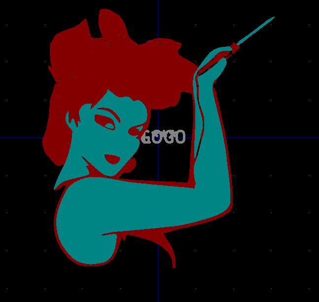

Creating the Art
The original Element14 art is well suited to conversion for PCB art but some modifications were made:
  • Colors were modified to fit the palette available as described below
  • Circuit art was removed
  • Hand and soldering iron were repositioned

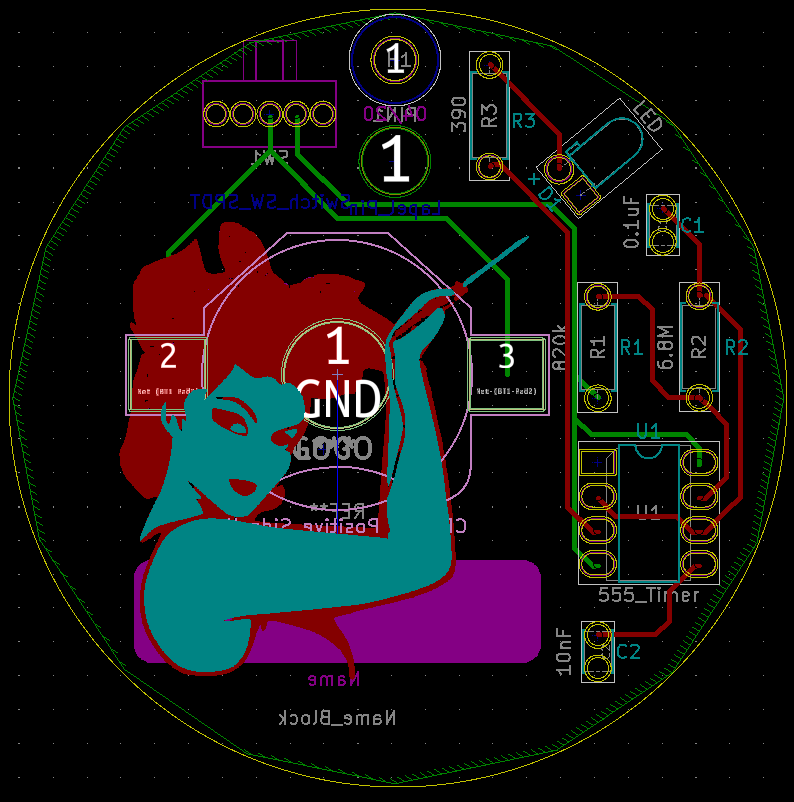

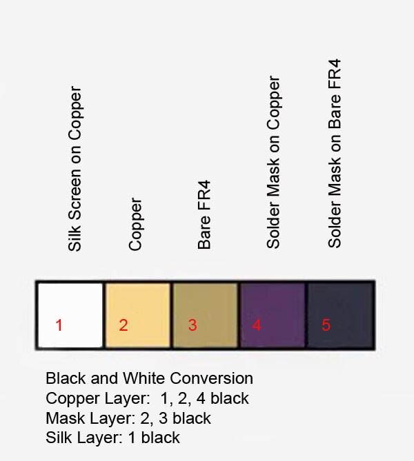

The method for transferring art to a PCB is described in greater detail in an earlier post located here.  My method uses Photoshop to reduce the colors to the color palette available and KiCad to create a footprint that can be inserted into a PCB design.  The colors available depend on the silk screen color, copper layer, and solder mask.  For example, when OSHPark Purple PCBs are used with ENIG on the copper the color palette is shown below:
The colors are broken into layers in Photoshop and then combined and converted into black and white images corresponding to the copper, mask, and silk layers shown at the bottom of the palette.  Next the black and white images are converted into component footprints in KiCad.  An additional manual step to combine the images is required as described in the link.
When finished, we have a footprint that can be placed on the PCB.

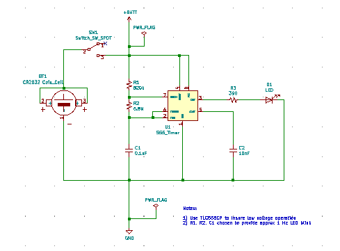

The Circuit
The circuit consists of a 3V coin cell powering a 555 timer in astable operation blinking a LED.
In this mode of operation the values of R1, R2, and C1 determine the frequency with which the LED blinks as well as the time it stays on (duty cycle).  The datasheet shows how to select components for different frequency and duty cycle and there are also calculators available online.  For more information on how the 555 timer works and the many uses there are a number of educational videos in Element14's The Learning Circuit series including this one.
To conserve the battery a switch was added so the circuit can be turned off.  The current limiting resistor R3 probably isn't necessary due the internal resistance of the coin cell battery but is good practice.

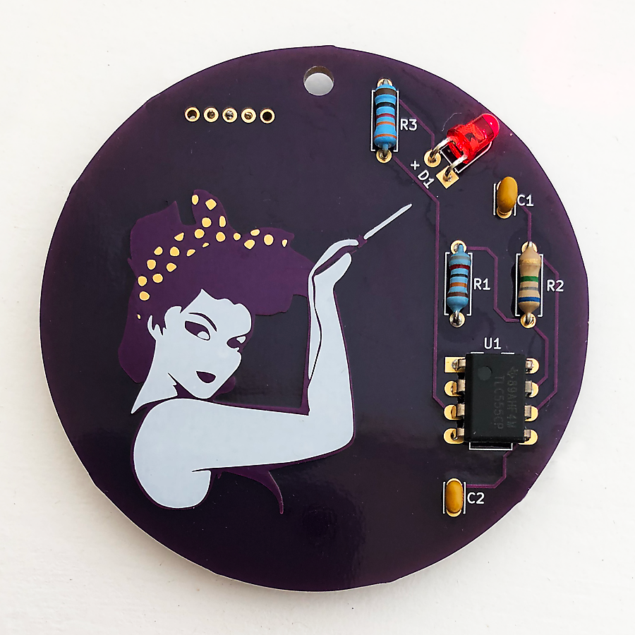

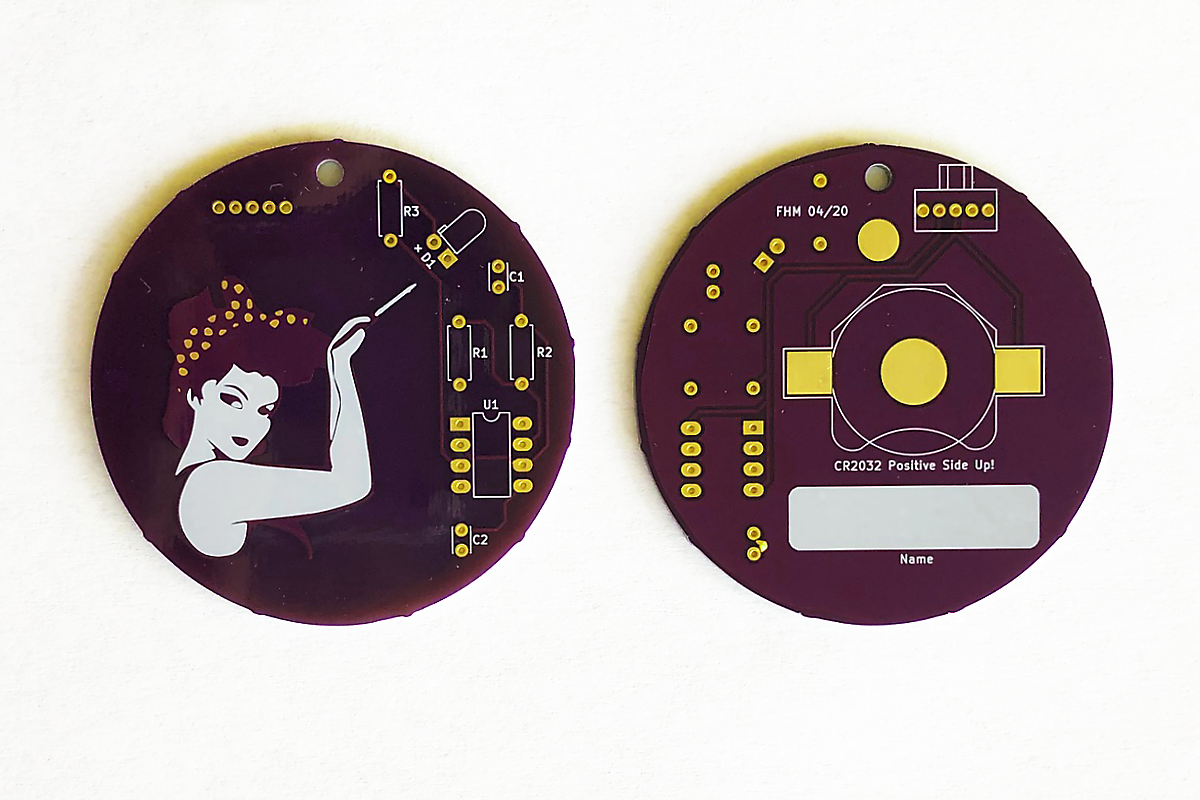

PCB
While larger surface mount components are not appreciably harder to hand solder we will start out with through hole.  Besides being a bit easier to solder they also look cool with the art image.  The image below from KiCad shows the layout and circuit tracks.
Red tracks are on the front of the PCB and green tracks on the back.  With the exception of the switch, battery holder, and name space all components and footprints are on the front of the PCB.  The fabricated PCB (unpopulated) is shown below.
NOTE:  The PCB has been modified slightly from the photographs above to make soldering easier but doesn't change the circuit or materially change assembly of parts.  The modifications are:
  • Distance between resistor pads was increased slightly
  • New switch DPDT with 2.5 mm pitch used for easier soldering

The order of assembly is not terribly important for this project as the parts are large and spaced well apart.  However, I soldered the low profile discrete components on the front first. These were followed by the 8 pin DIP IC (555 Timer) and finally the battery holder on the back and the switch.

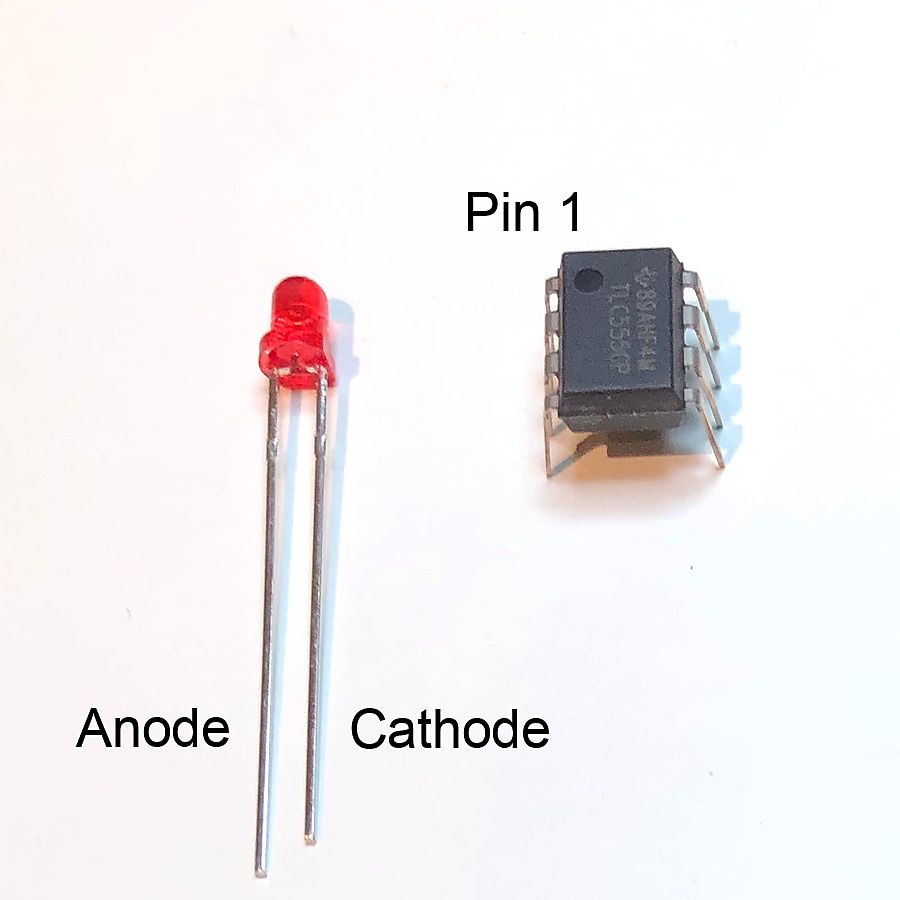

Use the schematic and the color codes on the resistors to place them properly.  Pay close attention to polarity of the LED and the pin placement on the 555 Timer.
The anode (positive) is the longer leg on the LED.  The cathode (negative) usually has a flat spot on the side of the case as shown in the photograph.  On the PCB there is a plus sign beside the pad where the LED anode is inserted.  The cathode is inserted into the square pad.
The 555 Timer has a circular indentation beside pin 1 (top left in the photo).  On some DIL (dual in-line) packages there may be a scallop shaped indentation at the top of the component next to pin 1.  Make sure to orient the 555 Timer correctly with pin 1 into square pad on this PCB.  A scallop shape next to pin 1 is also shown on the silk screen to illustrate correct orientation.  The photograph at the top of this post shows correct orientation.
The pins on the LED will need to be bent 90 degrees to place it horizontal with the PCB before soldering.  C1 has a tiny 104 written on it and C2 has a 103.  Reading the value of the capacitors is sometimes be difficult.  Accordingly it may be helpful to have a multimeter on hand that can read capacitance in case they get mixed up.  The pins on all components can be bent once placed in the PCB to hold them in place while soldering as shown in the photo below.
After soldering snip the pins off at an angle just above the solder joint.
