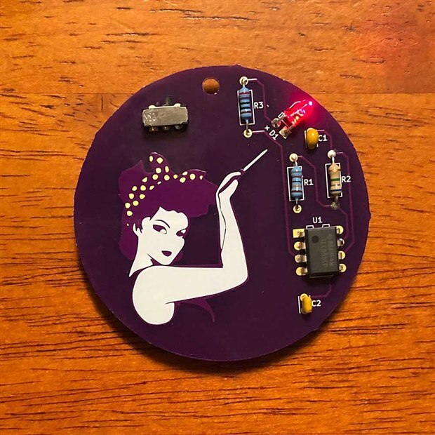

The Circuit
The circuit consists of a 3V coin cell powering a 555 timer in astable operation blinking a LED.
In this mode of operation the values of R1, R2, and C1 determine the frequency with which the LED blinks as well as the time it stays on (duty cycle).  The datasheet shows how to select components for different frequency and duty cycle and there are also calculators available online.  For more information on how the 555 timer works and the many uses there are a number of educational videos in Element14's The Learning Circuit series including this one.
To conserve the battery a switch was added so the circuit can be turned off.  The current limiting resistor R3 probably isn't necessary due the internal resistance of the coin cell battery but is good practice.
PCB
While larger surface mount components are not appreciably harder to hand solder we will start out with through hole.  Besides being a bit easier to solder they also look cool with the art image.  The image below from KiCad shows the layout and circuit tracks.
Red tracks are on the front of the PCB and green tracks on the back.  With the exception of the switch, battery holder, and name space all components and footprints are on the front of the PCB.  The fabricated PCB (unpopulated) is shown below.
NOTE:  The PCB has been modified slightly from the photographs above to make soldering easier but doesn't change the circuit or materially change assembly of parts.  The modifications are:
  • Distance between resistor pads was increased slightly
  • New switch DPDT with 2.5 mm pitch used for easier soldering

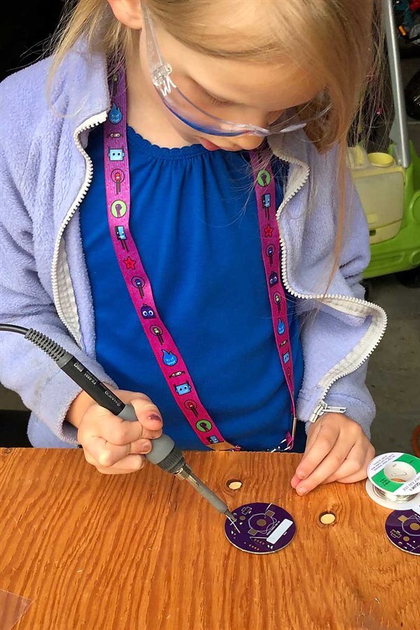

Soldering the Kit
SAFETY FIRST!  There is a safety list here.   Especially observe the following which I commonly see ignored:
  • Always wear eye protection
  • Use lead free solder - It is easier to get a good solder joint with lead based solder but this is project is for a wearable and will be handled.  Lead is especially dangerous for children.
  • Solder in an area with good ventilation and use a fume extractor
  • Do not multitask while holding a soldering iron - put it back in the stand
  • Always wash hands afterwards
When teaching children make sure there is adequate oversight for each child.
Sandpaper or a file can be used to smooth the edges of the PCB.  Take care to not inhale the dust.  Clean the PCB with alcohol if available.  If solder is not sticking, flux can help.  There is an introduction to soldering on PCBs with through hole components here.
The order of assembly is not terribly important for this project as the parts are large and spaced well apart.  However, I soldered the low profile discrete components on the front first. These were followed by the 8 pin DIP IC (555 Timer) and finally the battery holder on the back and the switch.
Use the schematic and the color codes on the resistors to place them properly.  Pay close attention to polarity of the LED and the pin placement on the 555 Timer.
The anode (positive) is the longer leg on the LED.  The cathode (negative) usually has a flat spot on the side of the case as shown in the photograph.  On the PCB there is a plus sign beside the pad where the LED anode is inserted.  The cathode is inserted into the square pad.
The 555 Timer has a circular indentation beside pin 1 (top left in the photo).  On some DIL (dual in-line) packages there may be a scallop shaped indentation at the top of the component next to pin 1.  Make sure to orient the 555 Timer correctly with pin 1 into square pad on this PCB.  A scallop shape next to pin 1 is also shown on the silk screen to illustrate correct orientation.  The photograph at the top of this post shows correct orientation.
The pins on the LED will need to be bent 90 degrees to place it horizontal with the PCB before soldering.  C1 has a tiny 104 written on it and C2 has a 103.  Reading the value of the capacitors is sometimes be difficult.  Accordingly it may be helpful to have a multimeter on hand that can read capacitance in case they get mixed up.  The pins on all components can be bent once placed in the PCB to hold them in place while soldering as shown in the photo below.
After soldering snip the pins off at an angle just above the solder joint.
Before soldering the battery holder put down a small blob of solder on the central negative pad as shown in the photo below.  This will insure good contact with the negative terminal of the battery.
Painter's Tape or some other easily removed tape is useful for holding the battery holder down while soldering as shown below.  Failure to do this or to use something like tweezers to hold it in place will result in burned fingers.  I sometimes put solder paste under the tabs but in this case just laid down a good amount of solder in the holes on tabs and it seemed fine.
The PCB in these photos is an earlier version and I subsequently selected another switch.  The new switch is a DPDT through hole version that is easier to solder.  It can be placed on the front or back of the PCB - your choice. After soldering and completing all components clean the flux off with alcohol and a brush.  Place the battery in the holder (positive side up) turn on the switch and watch it blink!

    Success!  We were outside so there was good ventilation and there was a small exhaust fan set up as well.  I had them stand at a low table so if they dropped the iron it wouldn't be in their lap like it would be if they were seated.  Here is my 7 year old granddaughter about to solder...
    She, her 8 year old brother and my son-in-law each soldered one.  I can confirm that the BOM listed above and the PCB itself all seem correct.  They all blinked on the first attempt.
    Everyone thought the switch looked better on the front so that is where we put it.  I didn't get many photos and no video because I was alone with the kids and needed to watch them closely.  But it was fun and successful.
