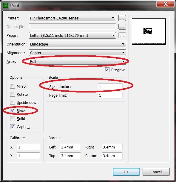

Step 1: With the board file open, select the layers of interest. I like to only look at 'TOP', 'PADS', and 'DIMENSION' layers because this test is only about the copper.
Step 2: Adjust the printer settings for a 1:1 scale, and hit 'Print'. The important settings are highlighted above. Scale factor is obvious, however the area must be 'FULL' since 'WINDOW' will result in an improperly scaled printout. Also, I prefer the 'BLACK' option to be selected since a black-and-white printout will work just fine.

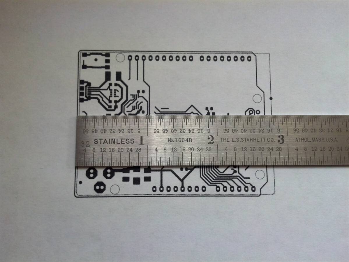

Step 3: Measure the board outline to be positive that all scaling has been done correctly.

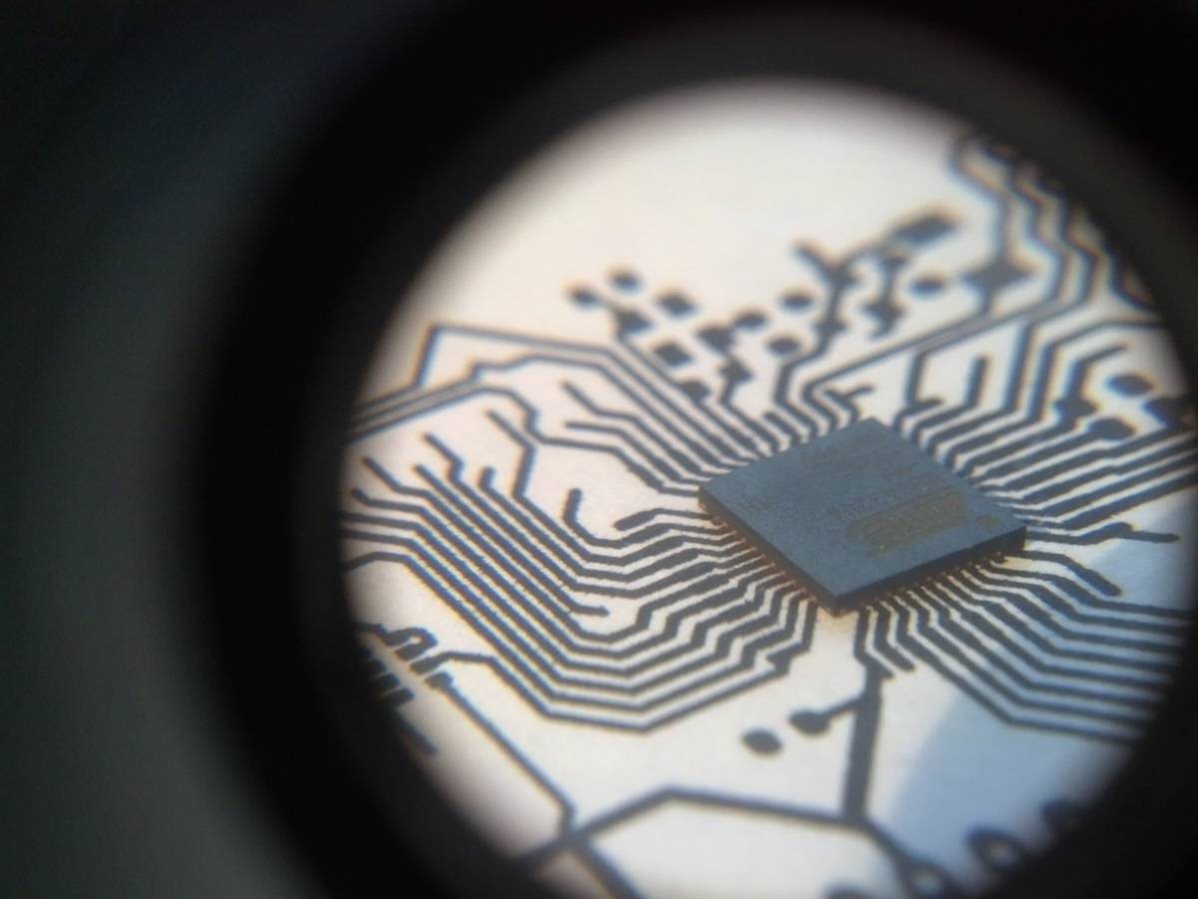

Step 4: Place each component on the printout and verify the footprint is correct. The image above shows a 0.02” pitch 44 QFN placed on a printout from a normal desktop printer. Anything smaller would likely require the use of a laser printer.

    There is another important option to mention. It is possible to calibrate the printout in x and y direction for the printer. Depending on the printer's qualitiy it might be necessary to adjust this.
    Thanks for your blog.
