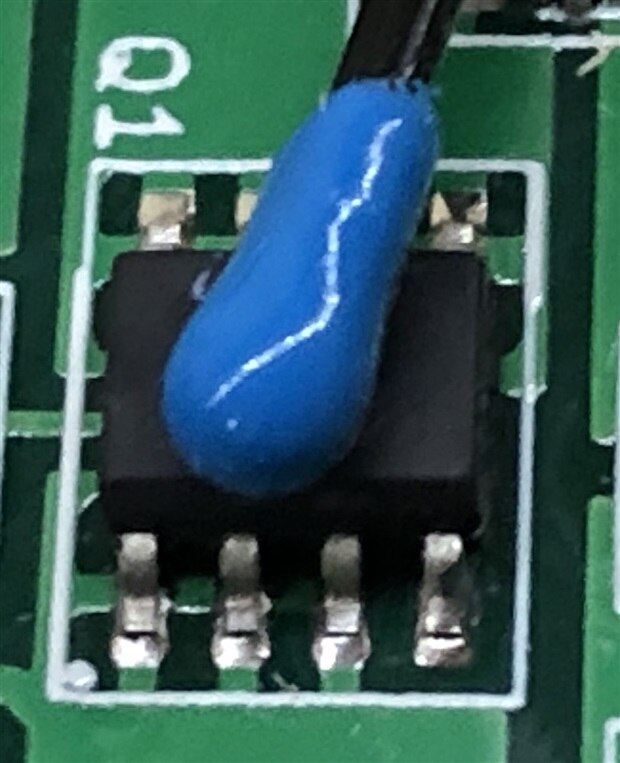

I've been looking around for the right search terms to use to find out how to stick a thermistor to the top of a 6mmx8mm chip (approx).
I have plenty of Kapton tape so I could use that, but I'd have to stretch it across multiple parts to get it to stick - I know it's non-conductive but still.  And frankly, it's not that sticky really either - I don't want to be opening a case to keep re-applying tape.  Is there some useful cement or sticky stuff that I could use - maybe something that I could remove the sensor without damaging anything if I wanted to but was secure enough to last.  At the moment I have it held in place with some blu-tack at the edge of the board but it's not really resting properly on the IC.

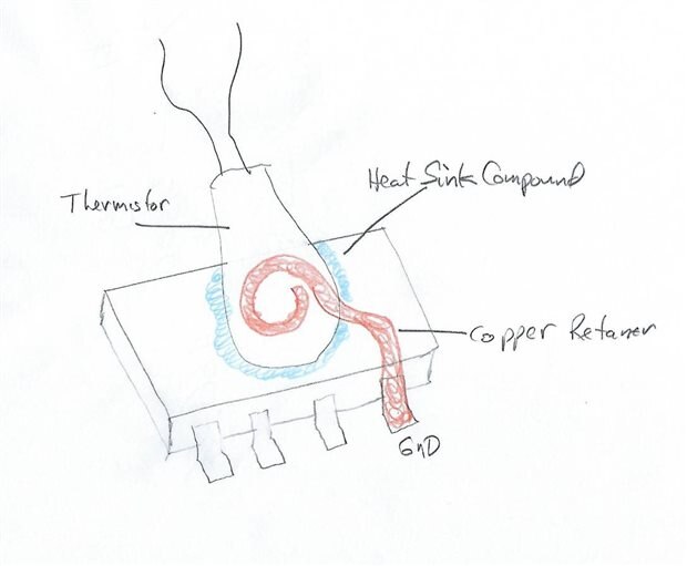

    jw0752 over 7 years ago +3 suggested
    This is just an idea. Perhaps you can tack a flattened copper wire to the chips ground terminal and loop it over the top to retain the thermistor. I would also use some heat sink compound to make a better…

    Andrew J over 7 years ago in reply to jw0752 +3 suggested
    The idea is a clever one John, but I think the springiness of the thermistor's wire would require quite a chunky piece of copper. Also, and you wouldn't know this of course, that pin labelled ground is…

    0 Andrew J over 7 years ago in reply to jw0752
    The idea is a clever one John, but I think the springiness of the thermistor's wire would require quite a chunky piece of copper.  Also, and you wouldn't know this of course, that pin labelled ground is actually a 'Gate' - the chip is a Mosfet, so no ground!  I was hoping that there was a special substance that could do this acting as heat sink compound but I don't know what it might be called to search for.  What I have found, is that if I were to use normal heat sink compound on anything, Kapton tape and tack won't stick at all.

    0 Gough Lui over 7 years ago in reply to Jan Cumps
    Try Thermally Conductive Adhesives category - e.g. in element14 Australia: https://au.element14.com/c/chemicals-adhesives/adhesives-glues/thermally-conductive-adhesives/prl/results
    • Reject Answer
  • Andrew J
    0 Andrew J over 7 years ago in reply to Gough Lui
    That’s the stuff I was thinking of.  I’ll look at those options, thanks both
