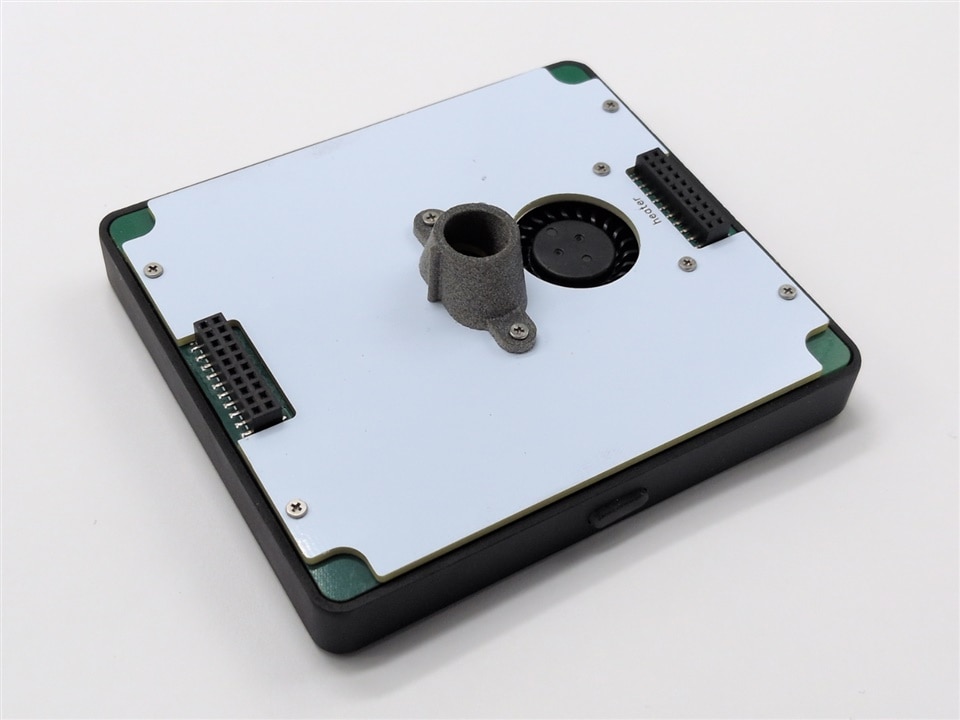

Hi everyone. I built a compact reflow micro-table for hassle-free PCB assembly at home:  Reflow Micro Table: Compact USB PD Reflow Table with Browser Control
I'd like to write a general guide on setting up thermal profiles, but I lack the practical experience to make something solid. I'm not talking about production-line requirements — more about "reasonably good" for advanced DIY.

    The colleague's method work well for me with an extra step to carefully push the soldered board off the plate after turning off. My plate has enough heat capacitance that the cool down rate is way too slow.
    On your plate (very nice and clean design btw), I would be interested in the temperature difference between your calculated temperature and the temperature on the top side of the board to be soldered. My experience is that the top temp always lags a few degrees behind the plate temp itself. If you want/need to be profile correct, this difference matters and needs to be taken into account.

    Personally, I have nothing against lead-free processes. But there are technical limits - existing power does not allow to reach desired ramp up speed for lead free. It's possible to reduce working area, but then comparison with MHP50 will be less impressive :). And as you noted, after additional temperature correction, to compensate losses, things may become too risky.
    According to cheap chinese thermal imager, and visual inspection of paste melting, in static state and 4-layer board with power polygons inside
    • about 10-15°C with LTS profile
    • about 20°C with leaded profile
    And with notable delays on ramp up. As you can see on video, bottom right corner - one pin of buzzer is melted even after cooling phase started (probably it was located on corner screw hole). But this is very heavy scenario for "home use". Self-assembly is more acrobatics than normal use :)
    Profiles are already adjusted - the leaded one has 230°C top instead 205°C. Probably, this can be more optimized, but this require more experience than I have in this area.

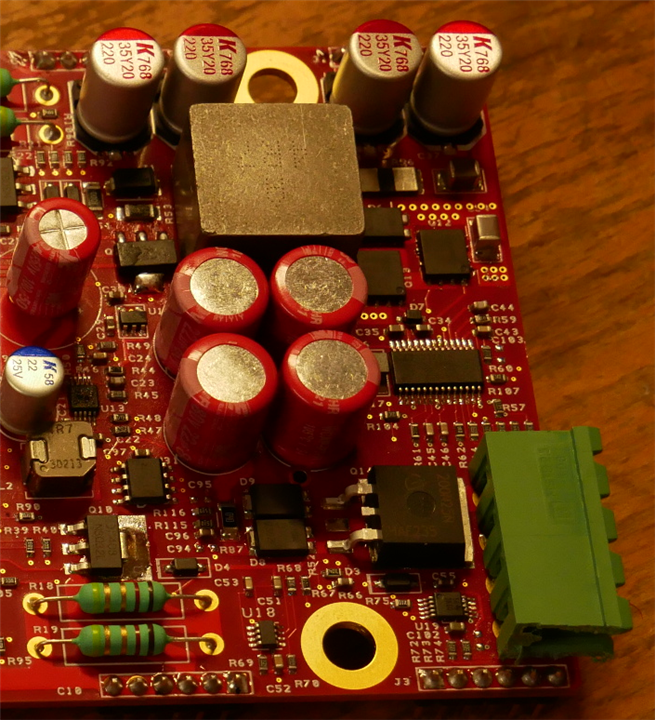

    For low volume home or prototype assembly I have found no value at all in setting profiles.
    All the following is based on leaded solder - I have avoided lead free except for a few occasions using the CIF IR machine.
    I currently mainly use a fairly expensive (CIF FT03 IR oven with internal air blowers) but before that I used under board hot air or a hot plate.
    With the under board hot air (and a very cheap air blower) you have almost no control over the pcb temperature so the technique is to observe the solder paste and wait until it flows at all points on the board, then give a bit longer for luck. This process is not very repeatable Slight smile and I have known it to kill chips.
    My hotplate technique used a cheap commercial hot plate. Set it to 30 - 50C above the solder melting point. Let it reach stability and place the board on it. Wait for the solder paste to flow - and then give it a bit longer.
    Recently the CIF failed to flow a board with my usual profile because of the presence of a very large surface mount inductor.
    The big SM Inductor and parts to the right of it and two of the SM capacitors did not solder in the IR oven using my standard reflow profile.
    Rather than scrap the boards I used the hotplate on the corner of the board  - considerable patience was required to reflow the inductor but the knowledge that the boards were scrap without soldering the inductor made me brave. The process worked and none of the other parts seem to have suffered.
    Using a hotplate like this is very much affected by the heat transfer between plate and board. It is necessary to press the board down on the hotplate since it will almost certainly warp as it heats up.
    The advantage of this process is that it can be used when you will only make (or salvage) one board and do not wish to scrap any. Developing a good profile requires experimentation. (My CIF machine could reflow the big inductor - I just wasn't willing to scrap a few boards to get there.)
    Your colleagues advice seems mainly good to me if the hotplate can ramp fast with no overshoot - but my hotplate isn't very good at ramping quickly. I've never seen a hotplate that cools fast enough and I favour getting the temperature down by removing the board.
    (Good solder paste and the use of a decent stencil are important !!)
    Putting though holes of a decent size (1mm or more) in the big pads on the underside of chips allows you to check that the solder has flowed under the chip and may allow you to remove the chip if you have to.

    In current configuration the ramp  up is ~ 1°C/sec in high point. Cool down ~ 1°C/sec until go below TAL, then become slower and very slow at room temp.

    Yeah. Thin plate => bad heat distribution. Fat plate => slow cooling. I use Pi5 fan to blow from the bottom. It improves cooling speed 2x-3x until melting point reached. But that's still 1°C/sec. Something more serious will not fit device size.
    The cheat is to end profile graph on melting point instead of room temp, lol :).
