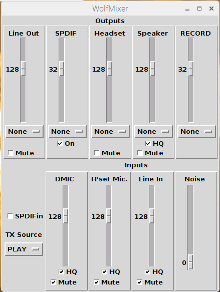

    As promised, I have updated my mixer program. I can also report that installing the pre-compiled kernel from
    RPi Linux driver for Wolfson / Cirrus Logic Audio Card
    works just fine on my Raspberry Pi 3 B.
    This is what the mixer looks like.
    You can get all the files by pointing File Manager to the folder in which you want the files downloaded, going to 'Tools/Open Current Folder ' in Terminal and pasting the following line into Terminal.
    git clone https://github.com/royleith/wolfmixer.git
    The files will be downloaded into a 'Wolfmixer' sub-folder.
    README.txt has all the instructions on where to copy the (Python) programs to, what to do with the desktop files and how to get the programs into the Application Menu and on to the Panel.
    When using the Pi 3 with its internal WiFi, the WiFi should be turned off when using BlueTooth to send your Cirrus card output to a BlueTooth player. Included in the files is a GUI program to turn WiFi off and on.

    cwbeacon over 9 years ago in reply to royleith
    I want to thank you for all your work getting this to run.  I got it all running on my Raspberry Pi 3 including your mixer.  But then I screwed something up with the mixer.  After a reboot when I try to run the mixer I get the following keyerror:
    File "wolfmixer.py", line 419, in <module>
       lineoutvar.set(statusquopatch(patchname))
    File "wolfmixer.py", line 367, in statusquopatch
       Rvalue = InputPortsID[para]
    Keyerror: '16'
    Thinking I had somehow messed up the python file I pulled down you files again.  Same error.

    royleith over 9 years ago in reply to cwbeacon
    @Mike,
    The mixer program uses the Python os module to issue command line entries to the program 'amixer'.
    The first thing the mixer does before setting up the GUI controls is to ask the amixer program for the current settings stored in Raspbian for each control. Python goes through a list of all the control and switch parameters asking for the 'status quo' setting.
    In your case, the program is asking amixer for the first existing setting in the Python list (lineout) and getting a rude reply.
    Since you have reloaded the mixer program, the problem is almost certainly due to amixer not giving a sensible reply to the command:
    amixer -Dhw:sndrpiwsp cget name='HPOUT2L Input 1'
    If you look at the 'usecase' scripts from Cirrus Logic, you will see that they also use amixer to set up patches and set levels and switches.
    The mixer command is asking amixer to check the sound device sndrpiwsp (the Cirrus Logic card) and ask for the current setting of the control HPOUT2L Input 1. (Each of the outputs has four input ports. Wolfmixer only uses the first port called Input 1).
    I suggest the following. Boot the Raspi and type alsamixer into Terminal. This will give you a character-mode control panel for all available audio controls. Use Function key F6 and this will give you a pull-down list of all available audio devices. If you do not see sndrpiwsp listed, then the audio driver is failing to load. I think that this is the actual problem. Check all the lines in config.txt et al to make sure the important lines have not been overwritten and make sure that the driver overlay file is still in the sub-folder.
    If it does appear in alsamixer, select it and use the cursor keys to move along the hundreds of controls until you find HPOUT2L Input 1 and make a note of what value you see. Please note that Wolfmixer does not display the same control values that you see in alsamixer.
    Then copy and paste the line,
    into Terminal and see what is returned. If it does not seem to make sense, then that is what is upsetting wolfmixer.
    Thank you for your response.  The Cirrus card is still working and I can use alsamixer to set the audio.   F6 returns the Cirrus card (0  snd_rpi_wso).  I disabled the built in audio on the Pi so I only show the Cirrus card.
    Looking in alsamixer  for HPOUT2L I find it connected to IN3L which is Line-In.  I hear Line-In audio out the Line-out jack.  I have MPD running so if I start that player and change HPOUT2L to AIF1RX1 I hear the mp3 files playing.  So the card and alsamixer is working.
    Running the command;  amixer -Dhw:sndrpiwsp cget name='HPOUT2L Input 1'  returns 104 items. The last line reads " : values=16".  That list looks the same as the items I get if I arrow up and down in Alsamixer.
    I think what I will do is go back to my original clean image and run through the setup again.  I am using the 4.4.14 kernel that I got from the horus.com site for the cirrus card.  Run through the setup again and see if it fails after a fresh install.
    @Mike,
    Hold on before doing anything drastic. amixer is working just fine and so is the driver.  The output you mention starts with,
    pi@raspberrypi:~ $ amixer -Dhw:sndrpiwsp cget name='HPOUT2L Input 1'
    numid=421,iface=MIXER,name='HPOUT2L Input 1'
      ; type=ENUMERATED,access=rw------,values=1,items=104
      ; Item #0 'None'
      ; Item #1 'Tone Generator 1'
      ; Item #2 'Tone Generator 2'
      ; Item #3 'Haptics'
    and ends with,
    ; Item #101 'ISRC3DEC2'
      ; Item #102 'ISRC3DEC3'
      ; Item #103 'ISRC3DEC4'
      : values=16
    amixer has enumerated (listed) all the possible patches and ends by telling you that patch No. 16 is currently selected. If you look down the list, No. 16 is AIF1RX1; the output from the Raspberry Pi to the sound card. It tells you that the Raspberry Pi is playing via Line Out and that is exactly what you selected in alsamixer (or the usecase script).
    If you look at the error report from wolfmixer, you will see that it is returning,
    Keyerror: '16'
    In other words, it is receiving the InputPortsID, correctly, as 16, but it is not setting the mixer to reflect that value.
    I ran wolfmixer on my Pi 3 and selected 'Play' as the input to Line Out (aka, AIF1RX1 connected to HPOUT2L Input 1) and got the same amixer result that you did.
    I see that you disabled the Pi audio. This is the only difference that I can see between your Pi 3 and my Pi 3 and two Pi 1s. Did you do that with  /etc/asound.conf containing,
