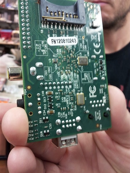

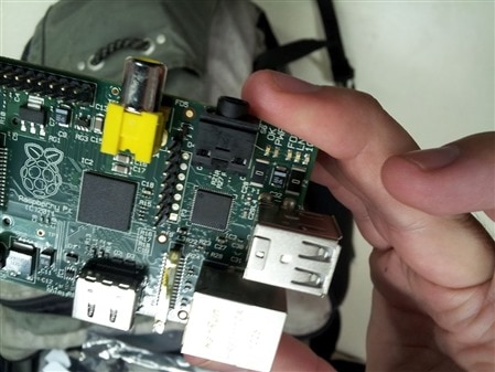

    Thanks for the heads up on the 0-ohm change.  Someone at my hackerspace Pi meetup last night told me he got his Pi from MCM last week, so I asked I could see it... and it was indeed "ohmless":
    I'm very interested to see at a future meeting what will happen when we swap his Pi into someone's setup who is having trouble with USB devices that might be power related.  With the USB host port polyfuses gone, I'm wondering if it is still be necessary to recommend using a self-powered hub for a WiFi adapter.  (the GWU625 I've been using lists "Transmit : < 380mA. ; Receive: < 250mA").

    I was tempted to replace the fuses by a pair of 0 ohm resistors but I only had 1206 size and didn't like how they landed on the pads,
    casually I had some 500mA polyfuses of the same size, so I used those.
    After the change I didn't have any problems to have an old Digitus Dongle with the Realtek 8187 chipset working directly from the
    one of the R-Pi USB ports, this dongle says on the ConfiguratorDescriptor.MaxPower: 500mA
    Ddin't do much to test if there is any packet loss issues with WiFi.
    -J

    For the polyfuse on the micro usb power input, I see on the eLinux wiki it is 1.1A with a hold current of 700mA.  Does that mean the Pi can only draw 700mA before the polyfuse starts to gain resistance and decrease the 5V input?
    I'm guessing the downside to 0-ohm or bigger 500mA polyfuse is that the USB devices can now draw enough current to make the power input polyfuse react.  I wonder if this would effect the functioning off the rest of the Pi (which I think it using 3.3V and 1.8V rails, right?).  Hookup an external harddisk directly and the Pi reboots?
    e14 Contributor over 13 years ago in reply to fustini
    We don't really know what the future plans are for power distribution. Morgaine has advocated that the USB power shouldn't go through F3. Some people have suggested 1 ohm instead of zero, or larger capacitors, in order to prevent voltage sags from hot plugged USB devices. Anyway, this change seems like an improvement, even if it doesn't solve all the power issues.
