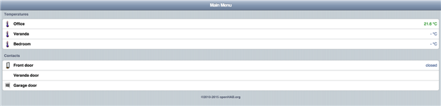

    Just tried the procedure, and doesn't seem to be working for me image

    0 fvan over 9 years ago in reply to cstanton
    You're right!
    I rolled back the changes from Brian's procedure and restored all files.
    Then:
    - Make sure everything is up-to-date: sudo apt-get update && sudo apt-get upgrade && sudo rpi-update (I think rpi-update did the trick for me)
    - Enable Serial via raspi-config, but edit /boot/cmdline.txt to disable serial console
    - Use /dev/ttyS0 instead of /dev/ttyAMA0
    - Reboot
    Data is now coming in OpenHab via EnOceanPi and EnOcean binding:
