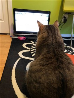

    0 ntewinkel over 8 years ago
    Hi All,
    Time for an update image  - I bought a little portable, battery powered, speaker at the dollar store, and the sound is working perfectly now.
    So I think those cheap little USB speakers had some power related issues.
    Happy Kitty:
    Thanks for all the guidance!
