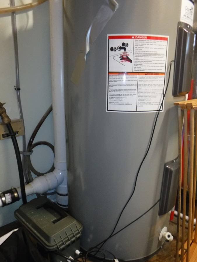

    The complete unit is assembled inside a plastic waterproof ammunition case. Sensors enter the case through waterproof passthough connector. I had intended to purchase a commercial grade waterproof case that I have used for other projects. On a visit to a Princess Auto Store I discovered waterproof ammo cases at a third of the cost of the units I would normally use. SOLD! Since this unit will sit outside, the ammo case motif looks rather cool.
    The ammo case can be seen in the picture. The unit was being tested using an aquarium until my hotwater tank went on the fritz. The water temperature in the house was fluctuating intermittently. I was unable to determine the root case using a multimeter to probe the components in the hot water tank electronics. I positioned the two pi_temp sensors above each of the tank thermostats and set it to record every 5 minutes. One week later data indicated the lower unit was not consistent. A quick thermostat replacement and viola problem solved.
