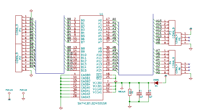

    0 Jan Cumps over 7 years ago in reply to colporteur
    If you only need level switching at the inputs, there's a fast (GHz) and cheap 16-bit solution for 5V -> 3V3, using the (critical: must be exactly this IC, not any other) : SN74CBT16245DGGR.
    Additionally, one jellybean diode, a 10K resistor and two decoupling caps.

    0 colporteur over 7 years ago in reply to Jan Cumps
    I have a few questions.
    The min voltage is 4.0 which is greater than 3.3VDC?
    I assume the power supply would need to be divided between 3.3VDC & 5VDC shown at the bottom?
    Do you have any experience with the circuit (i.e. used it in a project)?
    Sean

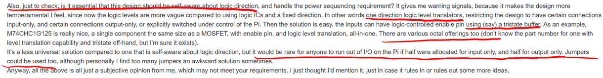

    0 shabaz over 7 years ago in reply to colporteur
    Hi Sean,
    These methods will switch a large quantity of signal directions, simultaneously. Does it meet your requirements?
    Somewhere, a compromise needs to be made, and I'm not seeing it.
    The MOSFET solution has serious limitations. The '245 and Jan's solution will switch a bank of pins simultaneously. It's not a bad thing, just that you need to specify if that is what you're looking for or not.
    The thing you were initially asking for (something that acts like a wire in both directions but also does level conversion, with no configuration of direction, and behaving open circuit until the Pi is powered up) is not what is being discussed now.

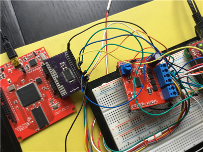

    Sean,
    I'm using the circuit constantly. It's the front-end to a FPGA-based protocol analyser. Photo taken just now from my bench.
    It's my home made version of the Gadget Factory Buffer Wing.
    The schematic above is mine. You feed 5V to the anode of the diode.
    Hi Sean,
    Your first design auto-switched direction, per pin. Is that a requirement or not?
    If it is not a requirement, then Jan's solution will work for you.
    This bus transceiver type method has been proposed several times in this thread. So just wanted to make sure.
    EDIT: I thought it was mentioned before.. we're going round in circles today, unless you make it clear if this is an acceptable design decision for you or not:
    colporteur  wrote:
    . If Jan's solution doesn't provide level conversion 3.3VDC to 5VDC then it is off the table.
    Sean
    It doesn't. Only 5V to 3V3. Other way around it passes the 3V3 straight trough.
