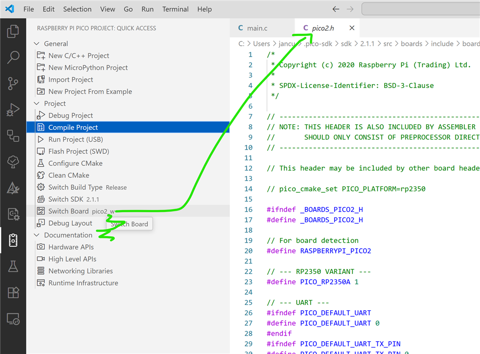

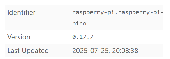

Raspberry pushed a new version of the Pico extension for Visual Studio.
This one doesn't seem to deal correctly with the board selection in the extension:
I deleted the build directory. Cleaned CMake. Configured CMake, Compiled. And it still thinks it's a non -w pico2 board with a LED on pin 25.
Anyone else tried it with a pico_w or a pico2_w?
edit 27-jul-2025
Solved. It was an error in my project's makefile. I had commented the board selection - expecting that the extension would manage it.
That caused that the extension couldn't switch the board. Removing the comment character fixed the situation:

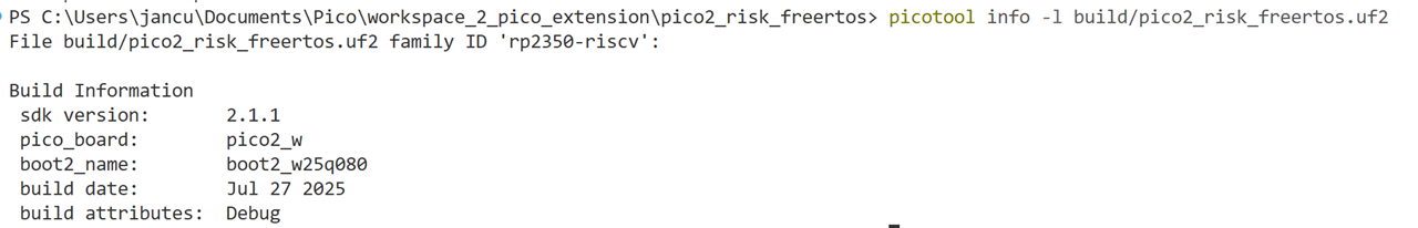

    I started by creating a new project from example for Pico 2 W (selected Blink) and compiled then flashed. Then I switched to Pico W, using the Switch Board option, and this worked too.
    Using same version as above.

    I started an issue on the extension github repo. Got first reactions back.
    My report is for an existing extension project: https://github.com/raspberrypi/pico-vscode/issues/196#issuecomment-3120477590

    Interesting. I just repeated test but this time I selected the RISC-V architecture when switching from Pico W to Pico 2 W and it still worked for me.
    When selecting RISC-V for Pico 2 W, I had to wait a bit while it downloaded the toolchain.

    Jan Cumps 4 months ago
    That caused that the extension couldn't switch the board. Removing the comment character fixed the situation.
    I closed the github issue with a comment and results.
