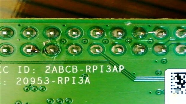

I received a new Raspberry Pi 3 A+ board from Newark/Element14 on Monday.
It arrived in a padded envelope instead of a box and the thin RPi box inside had been squashed.  This prompted me to do a quick inspection of the board and I was quite appalled by what I saw.
The first picture shows rework that was done on the board.  Very poorly done.  Solder reflow on the pads is bad and the solder flux and solder debris have not been cleaned off.
The second picture is of the GPIO connector.  The solder fillets are rough and you can see small balls of solder on the solder mask between pins.
I can't believe that this board would have passed final inspection.  The silk screen says Made in the UK.  I'm not sure where it was assembled.

    Hi Daniel,
    I received the RPi 3A+ from Adafruit today.
    The solder quality at the GPIO connector is awful.  Actually worse than the board I returned to Newark/Element14, although it doesn't have the other section of bad rework that the returned board had.
    I think the manufacturing line definitely has a problem.  I would guess the temperature profile on the through hole soldering process is incorrect and they are doing a horrible job of manual rework.  Hope that you have been able to provide feedback to the appropriate people.  And they also must not be inspecting these boards.  They certainly aren't cleaning them.  Do you know where these boards are being assembled?
    I am debating whether or not to try cleaning up this board and trying it out.  I don't see any pins that are obviously shorted, but there are a few that are close.  Wish I had a proper microscope so that I could send you some good pictures.  I guess if I touch up this board and it doesn't work that I won't be able to return it.
    You should probably have someone pull some boards from inventory and inspect them.
    Ralph

    I’d be interested in seeing what your board looks like.  Solder balls are worrisome enough, but I am seeing solder tails on pins that almost bridge between pins in a couple of cases.  I’ll need to get some pictures.  I guess I ‘m just unlucky image.  Do you see flux spots on the board that look like someone has done rework near through hole pads?

    Here is a picture of the GPIO connector on the board from Adafruit.  Sorry that I can't get better focus to show how bad it actually looks.
