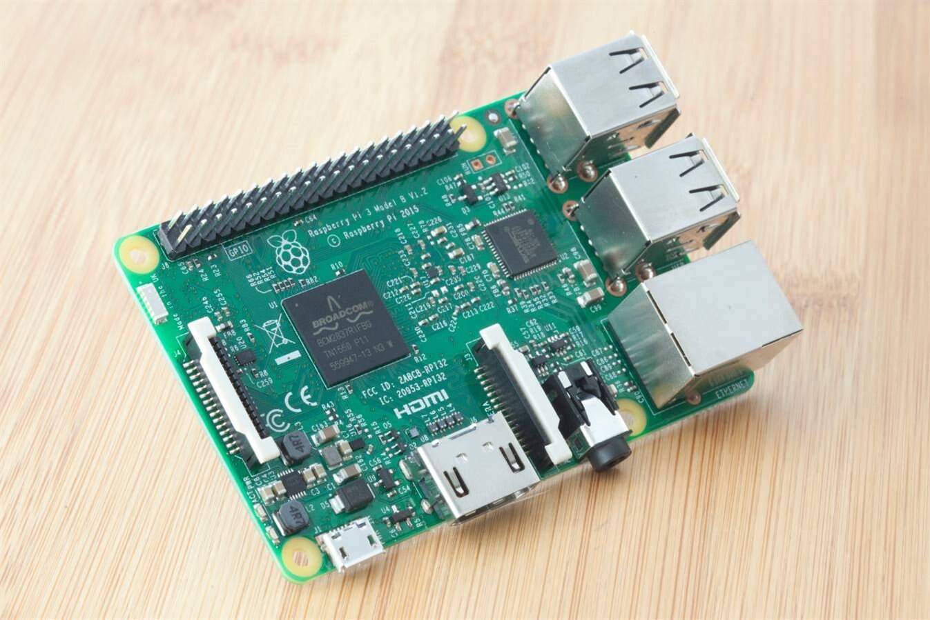

Recently we built a Plex Media Server using the Raspberry Pi 2, at the time the Raspberry Pi 2 was the most powerful board in the Raspberry Pi range. But on February 29th 2016 the Raspberry Pi Foundation announced their latest board, the Raspberry Pi 3.
Photo Credit - Raspberry Pi Foundation
Technical Specifications
  • Broadcom Quad Core 64bit CPU 1.2GHz  (BCM2837 SoC)
  • Broadcom BCM43438 WIFI and Bluetooth connectivity
  • 1GB RAM
  • VideoCore IV GPU and 3D now clocked at 400MHz and 300MHz respectively.
Raspberry Pi 3 Improvements
The new Raspberry Pi 3 is now 66% faster than the Raspberry Pi 2 and is approximately 10X faster than the original Raspberry Pi. The CPU of the Raspberry Pi 3 is an ARM Cortex A53 clocked at 1.2GHz per core, giving us the most powerful Raspberry Pi ever!
So how can this help our media server project?
  • Faster CPU, more CPU power enables our Raspberry Pi 3 to index our media library quicker.
  • 64bit CPU, 32bit operating system. The new Pi 3 CPU is 64bit, and while the Raspbian operating system is still 32bit, the extra headroom is still utilised giving us a speed boost.
  • Scaling CPU. The new Raspberry Pi 3 CPU can scale, enabling it to power down when not in use but spring into life when needed.
  • WIFI. The built in WIFI of the Raspberry Pi 3 is really fast. Working to 'n' standard, we can send HD video from our Pi 3 to any device on the network...wirelessly!
