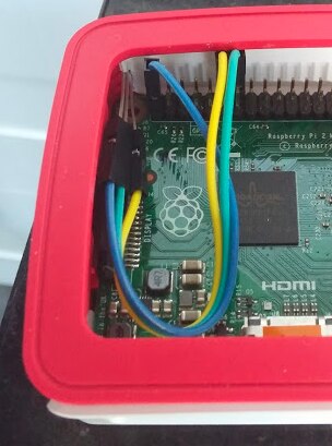

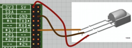

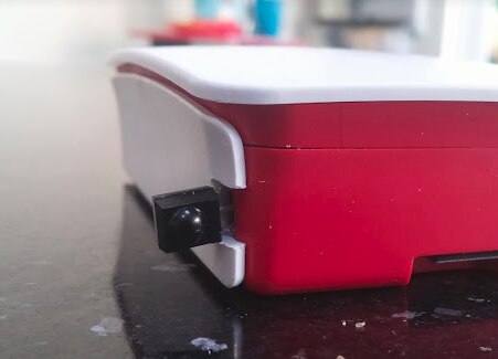

What I did first was buy a suitable IR receiver. I chose the Vishay TSOP4838TSOP4838 (which costs less than £1) because of the voltage range (2.5-5.5v) and receiver frequency (38KHz). If you look at the datasheet for the product, you'll see which pins should get wired up to the Pi;
Simply wire pin 1 to GPIO 18, pin 2 to GND, and pin 3 to a 3.3v power pin, e.g.

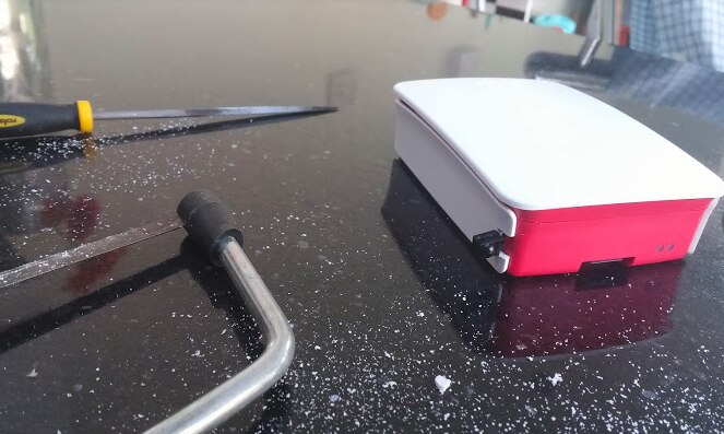

By using some short F-F jumper wires and a small cut in the side of the case, I was able to position the reciever neatly(ish) on the side.. it's still easily removable, but you could integrate it into the case a bit more seamlessly than this image

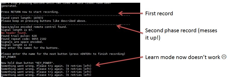

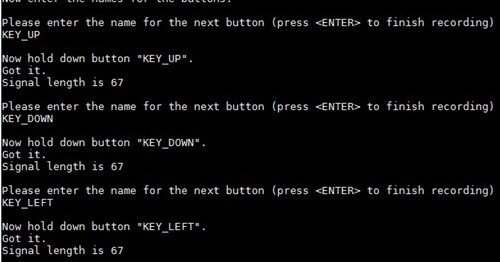

3. Now you can run the IR learn mode.. this will record what it finds to the config file you specify;
irrecord -d /dev/lirc0 /home/osmc/lircd.conf
4. Follow the on-screen instructions which will recognise your remote.
One observation I had was that this only worked properly if I stopped after the first prompt to press lots of keys on the remote.. if I completed the second stage, the key mapping didn't work, e.g.
If I ignored the second phase & let it abort, the learn process worked image
When it's working, you'll be able to enter the Kodi function (like KEY_UP, KEY_DOWN, etc)  & map it to a key press on your remote;

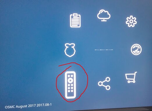

2. Now go into OSMC settings and pick the Raspberry Pi icon

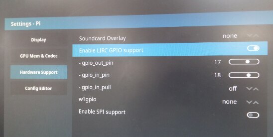

2. Go into Hardware Support and enabled LIRC GPIO Support. You shouldn't need to change anything if you connected the sensor to GPIO 18.

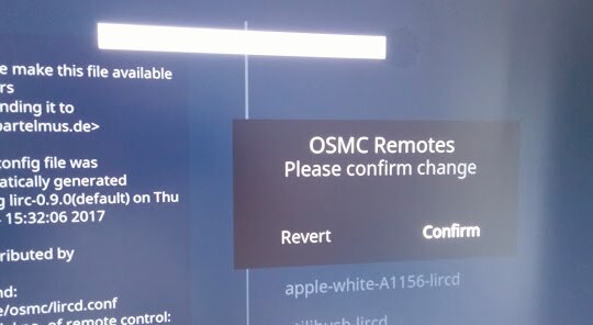

3. Now go back and select the Remote Control option;

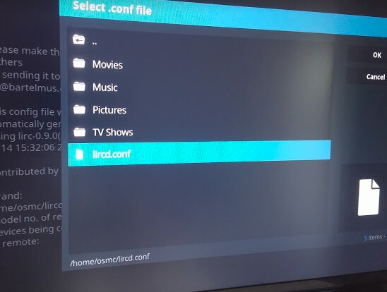

4. Ignore the list of pre-installed remotes and select Browse;
5. Navigate to the folder where LIRC wrote your config file;
6. Confirm the change & reboot the box;
