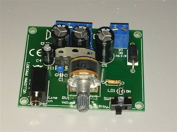

While I'm waiting for some parts to arrive, I decided to build the amplifier board that was supplied with the parts kit.  Here's what came in the kit:
Step 1 of the build was to install the resistor:
Step 2 was to install the diode:
Step 3 was to install the slider switch:
Step 4 was to install the ceramic capacitors:
Step 5 was to install the speaker and power connectors:
Step 6 was to install the audio connector:
Step 7 was to install the 100uF electrolytic cap:
Step 8 was to install the LED:
Step 9 was to install the integrated circuit:
Step 10 was to install the 1000uF electrolytic caps:
Step 11 was to install the potentiometer:
Here's the finished board:
And here's the tools that I used to build the board:

    DAB over 10 years ago +3
    Ah, but does to board work? You missed the final step. DAB

    pettitda over 10 years ago in reply to DAB
    As a matter of fact, it doesn't work.  The TDA1517 appears to be dead.  The board is only drawing less than a milliamp when on.  I doubled checked the construction and didn't find anything wrong.
