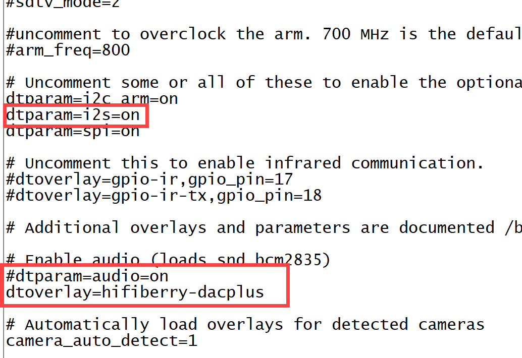

There is not much to do. As a super-user (e.g. using sudo), edit the file called /boot/config.txt as shown highlighted in the screenshot below.
Specifically, you're making three changes:
(1) Uncomment (i.e. remove the #) the line dtparam=i2s=on
(2) Comment (i.e. add the #) to the line dtparam=audio=on
(3) Add the line dtoverlay=hifiberry-dacplus
All of the configuration is shown completed in the screenshot below, in red. Once you’ve done the changes, save the file, and reboot! All is done.

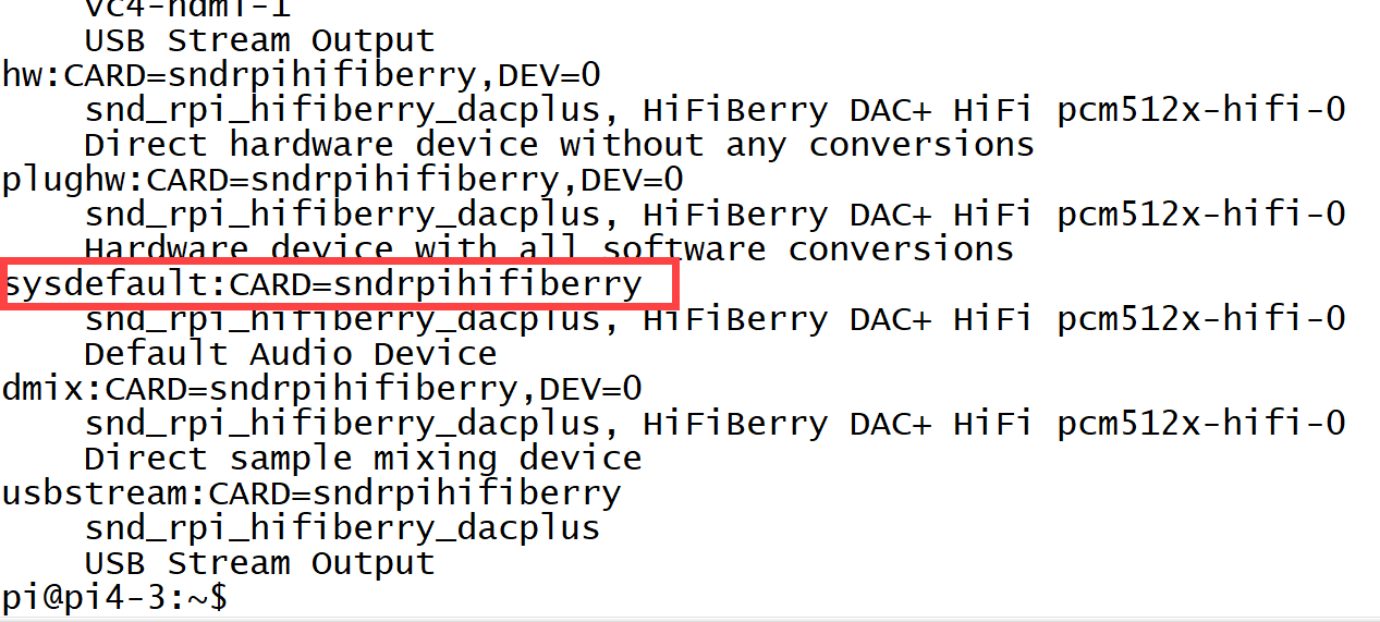

First, some tests. If you type at the terminal prompt aplay -L you should see the following:
If you type aplay -l (i.e. lower-case L), then the following should appear:
