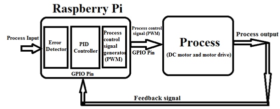

The traditional closed loop control system includes hardware circuits for the User Interface Unit, Feedback Circuit, Error Detector, PID controller circuit, and process control signal generator. We can integrate all these hardware functions using a single Raspberry Pi. The Raspberry Pi GPIO pins gather the inputs, feedback signals, and provide the output to the process. A  Graphical User Interface (GUI) can also be implemented to monitor and control the process. The logic for the PID controller can be implemented on Raspberry Pi by using any of the supported languages such as C, Java, or Python. A complete process control system can be implemented using Raspberry Pi as shown in Figure 1.
Figure 1: PID based closed-loop system using Raspberry Pi

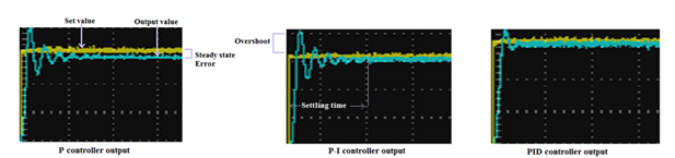

We can select any of these error compensation methods depending on the system requirement. Figure 2 illustrates the output of the different combination of error compensation methods
Figure 2: PID controller outputs
  • The P controller amplifies the error value and reduces the difference between the input and output of the system.
  • The combination of P and I controller improves the relative stability and reduces study state error, but increases the overshoot and settling time.
  • The combination of P and D controller reduces the overshoot but does not eliminate the study state error in the system.
  • The P-I-D combination is a universally acceptable compensation method for closed-loop systems. In this case, P, I, and D output is dependents on one another. If there is a change in any one of the controlled variable, it can affect the other two controller outputs. Hence, perfect tuning is essential to get better performance and stability in the system.

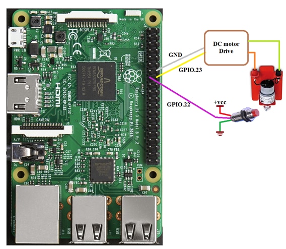

Procedure:
  • RPi.GPIO.22 is configured for the feedback input from RPM sensor.
  • RPi.GPIO.23 is configured as an output. It provides PWM pulses for DC motor driver.
  • Connect the Raspberry Pi display and Input-Output pins.
  • Connect the Power adapter and power up the raspberry pi
  • Download and run the DC motor controller code
  • GUI will open
  • Adjust the required RPM and PID gains using the sliders, now click the Start button.
  • The motor
  • Change the input RPM, PID gain values between the run state and observe the response of the motor.
  • After completion of your work press Stop button.
Figure 3: Connection diagram
