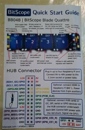

Following a discussion from DABs review of the Bitscope Blade Uno, I thought it was worth quickly mentioning the different sockets and pins you get on the bays of the blade.
03.jpgimage
Socket for Pi
This is a standard 2mm x 40 way socket for mounting the Raspberry Pi, it will fit all of the 40pin Pi including the zero.
Aux Power
This a 3 pin header with Gnd, +5v and Gnd. The power is aways on when there is power to the blade.
Power control
This is a 2x2 header with a jumper connecting +5v with the Pi sockets for 5v power. You can remove the jumper to disable the socket or attach a switch or relay. The other 2 pins are GND and GP21. This means that you could wire up a shutdown button to all of the Pi to be controlled either from a master controller e.g. the Pi in Bay one or an external switch. It might have been nice if Bitscope had provided a bit more information about what you might do with this connector as per the examples you see for some of the Pi UPSs.
Hub Connector
This is a cut-down version of the GPIO header on the pi, it is a right angle male connector on the bottom of the board. There are 26pins broken out including serial, I2C and some GPIO. So you could potentially wire these up to a custom board or across to a Pi accessory board. It does not include the Eprom pins needed for true HATs to work correctly.

    Yes, the idea they include in their documentation is that you could hook up four of their BitScope devices to  a single Rpi to look at 32 digital channels or 8 Analog channels and 24 digital channels.
    With their good software, that would give you a pretty good test and measurement capability for your benchtop laboratory.
