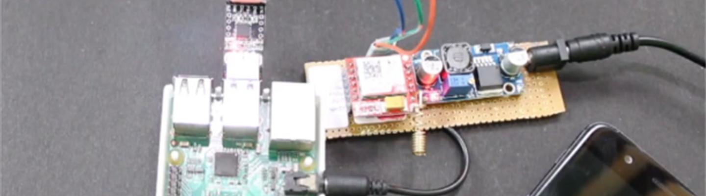

Emergency Calling System with SIM800 and Raspberry Pi 4
In emergency situations, quick communication can be a matter of life or death. That's why the Emergency Calling System with SIM800 and Raspberry Pi 4 was created – to provide a reliable and cost-effective communication system during critical moments. In addition, this system is customizable and can be easily integrated with other sensors and devices, making it a versatile tool for emergency response.
With the ability to make voice calls, send SMS messages, and access the internet, the emergency calling system is a powerful solution for those seeking a dependable communication system during times of crisis. In this article, we will explore the components of the system and how to build it.

Connecting the SIM800 Module
Once the Raspberry Pi 4 is set up, we can proceed to connect the SIM800 module. Here's how to do it:
1. Insert the SIM card into the SIM800 module.
2. Connect the antenna to the SIM800 module.
3. Connect the power supply to the SIM800 module.
4. Connect the USB to TTL converter to the SIM800 module.
5. Connect the USB to TTL converter to the Raspberry Pi 4.
6. Open the terminal on the Raspberry Pi 4 and run the following command to install the required libraries for the SIM800 module:
sudo apt-get install ppp usb-modeswitch wvdial
7. Create a new file called "wvdial.conf" in the home directory using the following command:
sudo nano ~/wvdial.conf
8. Add the following lines to the "wvdial.conf" file:
[Dialer Defaults]
Init1 = ATZ
Init2 = AT+CGDCONT=1,"IP","internet"
Modem Type = Analog Modem
Baud = 9600
New PPPD = yes
Modem = /dev/ttyUSB0
ISDN = 0
Phone = *99#
Password = { }
Username = { }
9. Save and exit the "wvdial.conf" file.
10. Run the following command to start the PPP connection:
sudo wvdial
11. If the connection is successful, you should see a message indicating that the PPP connection is up.
