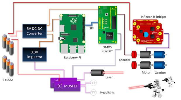

Circuit Overview
The diagram below shows the main components used; click to enlarge.

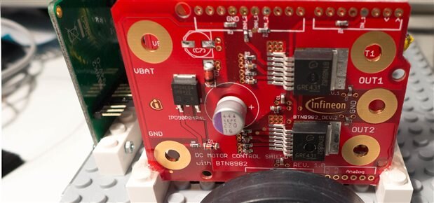

XMP-1 relied on continuous rotation hobby servos which are fairly inaccurate. XMP-2 uses brushed DC motors and Infineon H-bridges to power them. All motor control occurs using the XMOS xCORE processor. For closed loop feedback encoders are used. These are connected to the XMOS board so that the xCORE processor can count pulses (tens of thousands of pulses per second - around 60k pulses per wheel revolution in this design) as the motor turns, calculate appropriate pulse width modulation (PWM) which then drives the motors through the Infineon H-bridgesInfineon H-bridges. The closed loop feedback means that the robot can make movements with accuracy and allows for motion even at slow speeds where open-loop PWM in ineffective as soon as the motor encounters a load. For more detail on closed-loop PWM and control of brushed motors, check out this post which used a BeagleBone Black for controlling motors. To get a basic understanding of different motor types click here. There is also a post on the Infineon DC motor control H-bridge boards which were used.
Click here for a video showing a practice run of just the motor control portion (before the robot was complete).
XMP-1 required two power sources. This time round a single battery source (initially non-rechargeable batteries) is used to power everything. To further simplify things, a custom PCB will be created at some point to replace the mass of wires and also provide a rechargeable battery solution.
The entire robot (including motors, XMOS board and Raspberry Pi) is powered using six AAA batteries.
The XMOS board was used to control the motors while relying on feedback from the encoders. Another aim is to eventually implement a vision system to be able to navigate around objects autonomously.

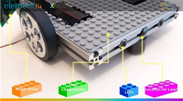

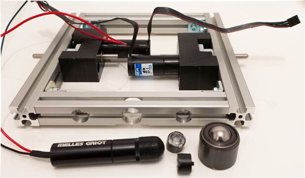

Mechanical Overview
A classic differentially steered design was created with two wheels that are driven by the motors and the speed and motor direction can be controlled. The third wheel (unpowered) was actually a ‘ball transfer unit’ (from Alwayse Engineering,  model 7101) which is a bit like an old computer mouse ball but usually operated in the inverted position for conveyer type systems. Another ball transfer unit was used for stability and becomes the fourth wheel.

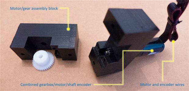

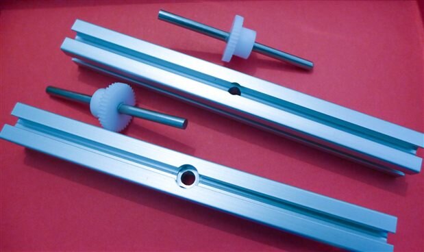

The motor unit has built-in gearing and a built-in encoder – it is available new from Faulhaber (Series 1524..SR) and is also available in used/repaired condition via eBay from several sellers. It is further geared down using a gear from motionco – primarily to decouple the motor unit from the output shaft for reliability but also to reduce the motor speed and increase the torque. Everything is held together using a motor/gear assembly block made from plastic. To build something similar schools/colleges may have a machine shop or a 3D printer and accurate drill press could be used (sub-millimeter accuracy is needed to mesh the gears properly). Don’t forget to wear eye protection.

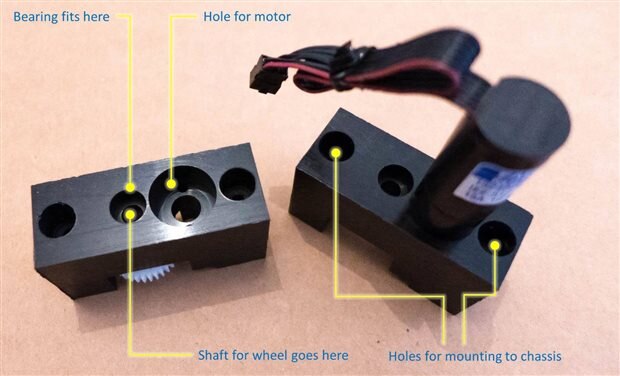

The slide show below shows the motor/gear assembly block construction and how it was fitted to the chassis. The wheel shaft and bearings were from motionco too. It was decided to have a 4mm diameter output shaft to the wheels. The chassis is built using aluminium extrusions (available from eBay) with rounded edges – far safer than the XMP-1 design.
{gallery:autoplay=false} Motor/Gear Assembly Block Construction
Assembling the block: The motor can be seen inserted at the right
Mounting the motor: The motor fits into a part-bored hole and is secured with two small bolts. There is a small recess for fitting a bearing for the axle
Attachment to chassis: The center hole shown here is bored to two diameters, one for passing the axle through, and the larger diameter is for fitting another bearing
Axle and Gear: The gear is glued to the shaft

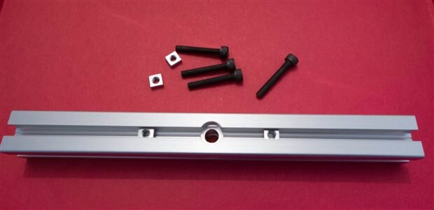

The photo below shows the assembled chassis with the motor/gearbox blocks mounted, a ball transfer unit and lenseslenses and laser.

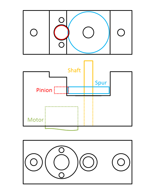

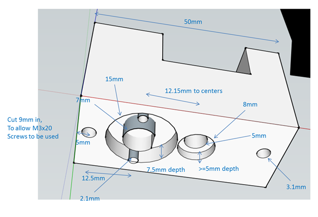

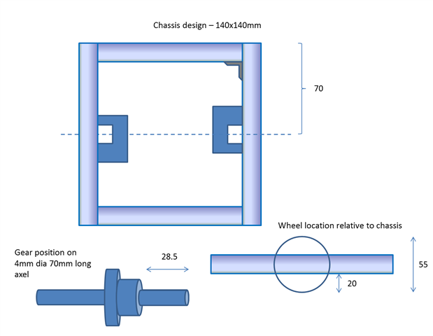

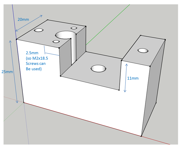

Engineering Drawings
If you’re building a replica and intend to closely follow the design, then the slideshow below contains the detail on how to construct the motor/gearbox mount and chassis:
{gallery:autoplay=false} Engineering Drawings
Motor/Gearbox Block: Poor diagram but it gets the point across hopefully; dimensions from the rear of the block
Motor/Gearbox Block: View from side
Motor/Gearbox Block Assembly: How the bits fit together
Assembly: This photo shows how the motor/gearbox block, axle and chassis fit together

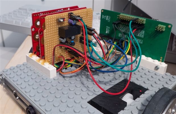

Lego Integration

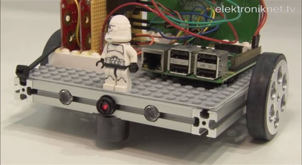

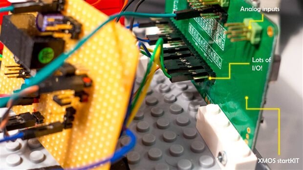

Lego was instrumental to mounting most of the electronics. It allowed the design to be implemented quicker without needing to worry upfront where precisely all the boards would be mounted. The photo below shows how the XMOS startKIT was mounted. Two white 4x1 blocks were drilled and screws were used to secure the XMOS board to them. In the photo below, the stripboard on the left contains all the power supply circuitry.
The stripboard and the Infineon boards were also mounted using Lego; they were glued into notches cut in Lego as shown in the photo below:

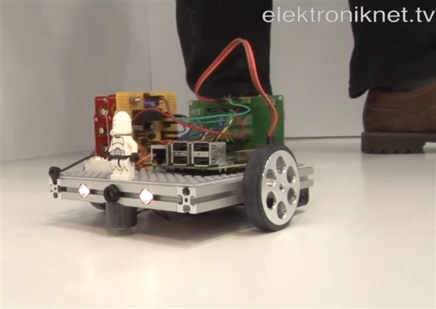

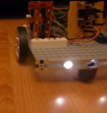

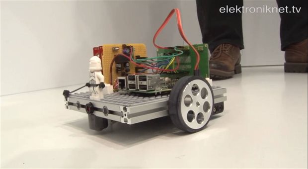

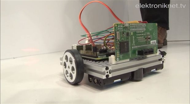

The slideshow below shows what the robot looks like from various angles (laser and headlights powered up in some of the photos):
{gallery:autoplay=false} XMP-2
Front View: Laser powered up
Front View Closeup: Stormtrooper keeping watch
Rear View: The XMOS startKIT can be seen here. It has a 3x3 matrix of LEDs which could be used for status/notifications
Side View: 'Micromouse' style wheels were used
Front View: Headlights lit up!

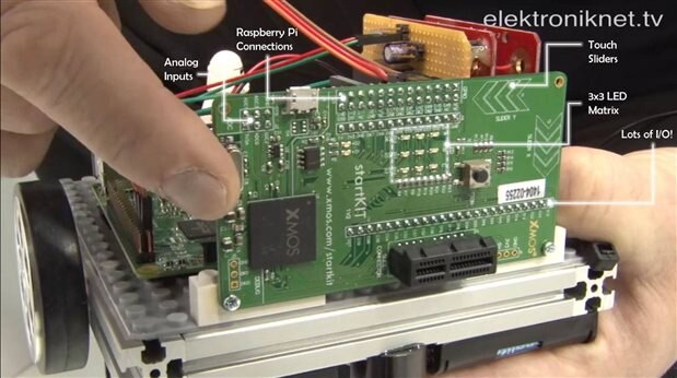

The XMOS board can be seen close-up below:

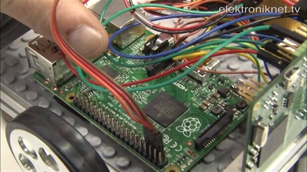

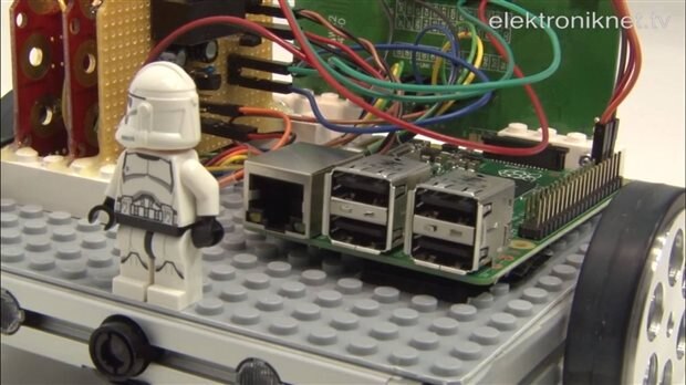

The Raspberry Pi can be seen installed in the photo below:

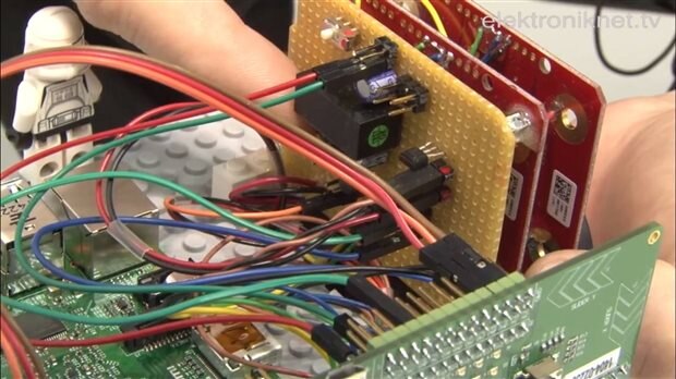

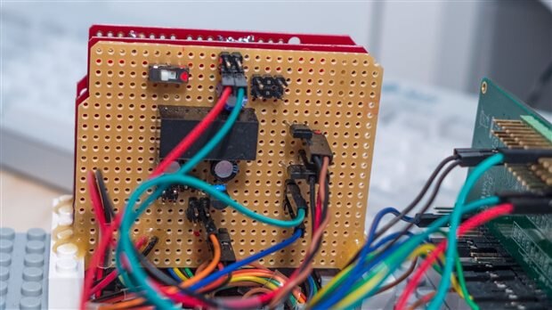

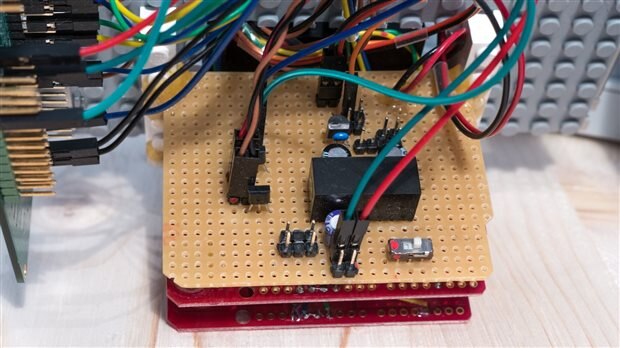

Here are some more photos of the circuitry. A DC-DC converter DC-DC converter was used to provide 5V for the processor boards. It is the box-shaped component in the photos. A small 3.3V LDO regulator3.3V LDO regulator was used to power some logic gates for the rotary encoders. The power switch can also be seen soldered onto the stripboard above the DC-DC converter. Red dot indicates powered on position!
Another view. A few electrolytic capacitors are used as recommended by the DC-DC converter and LDO datasheets. A few ceramic caps are on the underside (not shown).
The wiring may look messy but it was mostly color-co-ordinated and easy to follow. Notice the XMOS StartKit has had header pins soldered on the rear of the PCB, not the front side, for ease of assembly (and I wanted the LED array on the XMOS StartKit to face the other side).

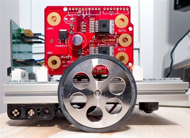

The red Infineon boards can be seen glued into notches cut in the white Lego pieces. The StartKit was bolted using holes drilled in Lego, so it is easily removable.
Side view. The large electrolytic capacitor that is present on the Infineon boards by default was reduced in value due to the low current requirement of the motors that were used.

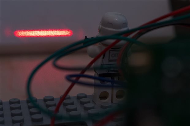

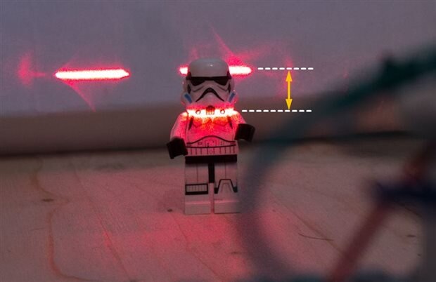

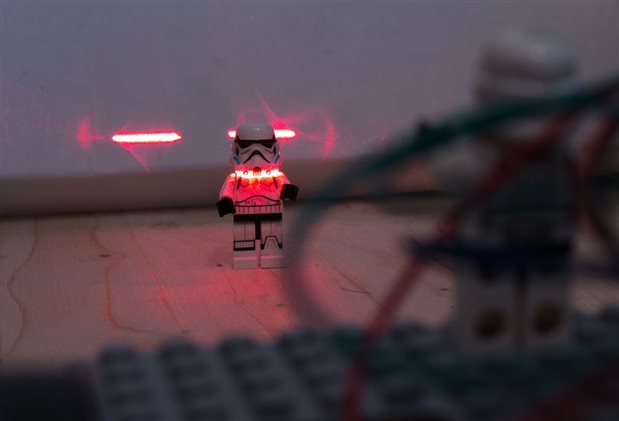

Laser Ranging
The photos below show the principle that could be used for laser ranging.
The first photo here shows the default view against an example (cardboard) wall. The laser beams a line pattern (it has a special lens to do this):
This next photo shows what occurs when a Stormtrooper is positioned between the laser and the wall. Notice the horizontal laser projected line has been cut, and is reflecting off the Stormtrooper:
From the height difference between the horizontal line off the background wall and the reflected line off the Stormtrooper, it is possible to deduce that an obstacle (the stormtrooper) exists, and the deduction can be done with very little image processing needed.
