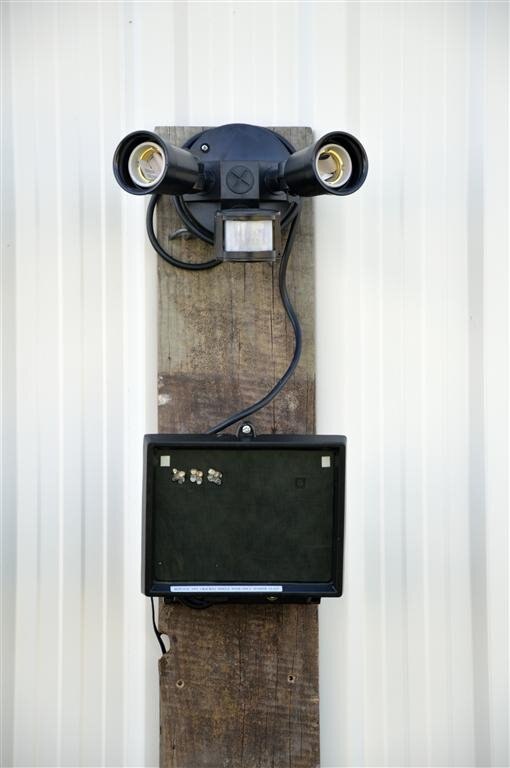

While this was coming, I was asked to do something using the RPi and NoIR camera for security to include in The Shed magazine
It provides a perfect solution to those expensive and very obvious security cameras.
I chose to use an outside floodlight and modified an outdoor movement sensor to run off 12v, as the trigger device.
These were mounted on a board for testing, but can be fitted seperately, along with lamps that never come on...
The text of the article has been generously provided by the publisher and is attached.
(and yes it uses the normal camera image rather than the black NOir camera, its called poetic licence)

    mcb1 over 12 years ago in reply to Problemchild
    have you found it to be OK with fogging and damp ?
    It hasn't had the full blown tests yet, as I ran out of time, but I want to keep working at it.
    Its behind the normal heat tempered glass that comes with the floodlight. (in the picture above)
    The movement sensor at the top is simply just a PIR feeding an open collector to GPIO 23.
    At the moment our weather is in the 20-30deg C range, but does get dew at night, so early days.
    your Camera up a mountain
    Its an idea, but I decided to use an external Wireless AP that has been used in several skifields with no failures.
    It has the advantage of allowing a piece of pvc to slip over it to aid in the protection against snow and ice.
    The external device approach also meant I can use the wireless for other data in the future.
    But its still a very good concept and has great potential.
