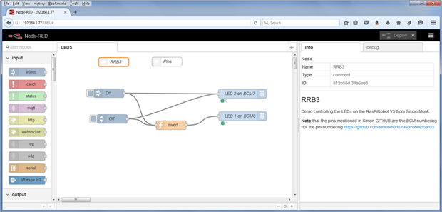

LED Example
My first experiment was to turn the 2 LEDs on and off. I created a couple of "inject" nodes as those come with buttons to press on the left. One was configured to send a 1 and the other a 0. I then added some GPIO nodes and a function node which was coded to invert the signal. These were wired up as follows. The only "issue" I found was that Simon's pins referenced the BCM (broadcom) numbering not the pins on the header. Once I'd fixed that the flow worked fine.
Source - Library - Node-RED

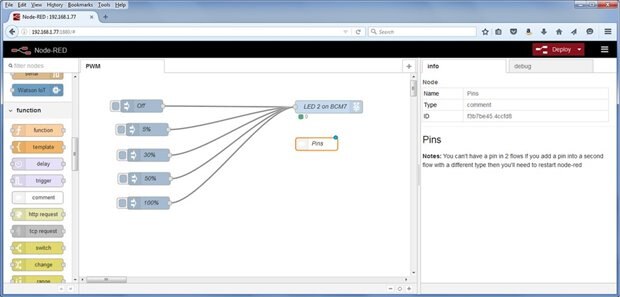

PWM Control
The first issue I had when I tried to create a new flow was that the pins were already used on the previous flow. I saved that off and deleted it. I restarted node-red and was able to add the new flow.
The flow has 5 switches that pass the values 0 to 100 to the pin. The Pin is configured for PWM control. I found that the brightness did not seem linear so I selected specific values for the inputs to compensate for that.

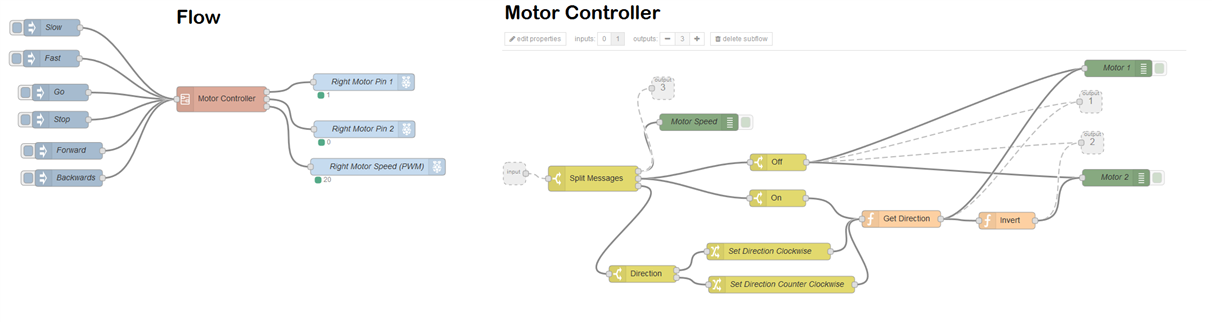

Motor Control
The motor control is a combination of these two approaches. However, because of the control requirements for the H-Bridge chip I needed to create a complex flow to convert from on/off/back/forward into the pin values for the chip. This was handled by a sub flow and some flow specific variables.
The fast and slow injectors have a message type of "Speed", this is detected by the split message note and passed straight to output 3 to control the speed pin.
Go and Stop have a message type of "On", this is also picked up by the split message and sent to the on and off nodes. Off turns off both 1 and 2 outputs, On passes to the get direction function which reads the direction variable and then generates a H/L or L/H depending on the value.
The forwards and backwards node have a type of "Direction" so are split out to the flow at the bottom. These save the value of the direction to a flow specific variable. This flows on to get direction node and handles the direction in the same way as the On flow.
