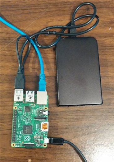

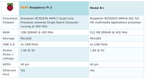

A couple years ago, I showed how to setup an ownCloud server on a Raspberry Pi.  The system worked, but there were some performance hiccups. Most importantly was the ability for the system to handle large files and for the Pi v1 to take on the task in a speedy manner. I found myself using Microsoft’s OneDrive more often, electing to use their more proven platform for anything that didn’t require tight privacy controls and a firm handle on my data’s location. Still, it was a small, secure, and low-power cloud storage solution.image
With the latest release of the Raspberry Pi 2Raspberry Pi 2, I thought this was a perfect time to update both my hardware and software in hopes of seeing performance improvements. The result gave ownCloud a whole new lease on life, at least in my lab. Check out my video showing the system and its performance:
I can’t be sure if it is the upgraded hardware, the updated linux OS and packages, changing to an nginx server, or the latest version of ownCloud, but the system worked much better. I had the server up and running within a few hours, and the web and desktop clients singing minutes after that. But the Pi2’s vastly improved specs have to be part of it:
Although things are greatly improved, it still can’t beat the usability of OneDrive. I tried creating issues for the system by uploading a 1GB file from ‘Computer A’ over a browser, uploading music files from ‘Computer B’ via the client, and quickly browsing the files from ‘Computer C’ over a browser. It worked for a while, but it had difficulty on the 1GB file upload and caused a sync error to flag on the client. Thankfully after a few minutes the system figured itself out and updated everything as one would hope. Stability and storage integrity is the ultimate goal so this is yet another example of trading patience/minor hassles for privacy.
I looked at some customizations like overclocking, but decided against it on account of stability trumping speed when it comes to data storage. Waiting a few seconds or even a minute for a webpage to load or a file to sync is annoying; having the system go down when a critical file is needed is simply unacceptable.
The ease of use, extremely low cost, and improved performance makes for a viable system when trying to control data and its privacy. With the new world of cloud-based systems everywhere it’s easy to forget that data is a tangible asset and must be considered as such!
While there are a few tutorials out there relating to Pi ownCloud servers, I couldn’t find one that was used with the Pi2 and OwnCloud v8 and solved all of my size limitation issues, so here are the steps that I followed to get the system installed and running.

27. Visit the location of your Pi’s IP (mine was 10.0.0.124) with a browser to access your ownCloud Server and create an admin account! Note that without cURL installed, there may be an error for files over 4GB. But since this setup limits the files to 2GB, that’s no big deal.
28. Install ownCloud's free client/app on any of your machines, or elect you just use the browser interface.
29. Implement your favorite method of allowing access to your Pi2 from the internet. These steps vary from network to network and modem to modem, but here are a few resources that may help:
