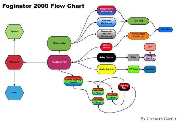

The Concept

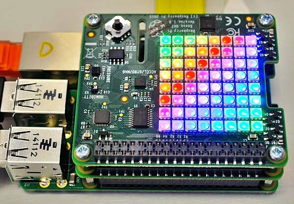

The basis of this project is to utilize the all new Sense Hat from the Raspberry Pi Foundation to work in conjunction with the Raspberry Pi and a Relay to activate a fog machine when guest trigger a motion sensor. For those of you who might not follow new Raspberry Pi products as myself, the Sense Hat features an array of environment sensors that relay data back to the Raspberry Pi. To be honest, I struggled to figure out how I would tie the Sense Hat back into this project, and after a few conversations with friends I think I have come up with an idea.
I am going to utilize the Sense HatSense Hat to log data about the environmental conditions on Halloween Night and use the fog machine triggers to log what I will call a “Trick or Treat” event. When the night is over, I will compile the data and try to determine if swings in temperature, humidity, or air pressure correlates to a rise or fall in trick or treat events.
I will also utilize a few more of the Raspberry Pi’s GPIO pins to trigger some special effects lighting (NeoPixels), and will play an array of spooky ambient sounds, halloween-themed music, and (if time allows) audio events when the fog machine is triggered. One final bonus feature will be to integrate some form of remote notification when a trick or treat event occurs.
This project will progress a little faster than my Trick or Trivia Candy Dispenser project, mostly because I am building both at the same time. I purposely kept this project a little more simple for this reason. You will also note that I have chosen to use an off-the-shelf relay module this time instead of building my own as I will be doing in my other project. This is both in the spirit of saving some time, but as well to illustrate that there is alternative solutions that are ok to use as well.
