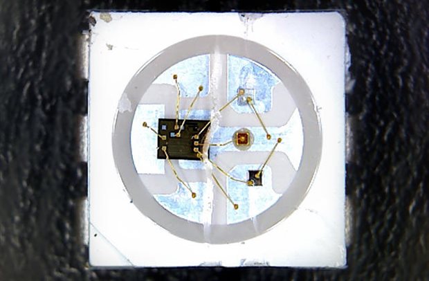

Neopixel’s are the brand name for the popular WS2812B individually addressable RGB LED modules, and are marketed and sold by Adafruit here at Element14. You can find WS2812B strips, rings, sticks, and individual modules on various electronic retail outlets as well, but for the purpose of this project, I will be using genuine Neopixel strips and rings from Adafruit.
The NeoPixel line is the latest advance in the quest for a simple, scalable and affordable full-color LED. Red, green and blue LEDs are integrated alongside a driver chip into a tiny surface-mount package controlled through a single wire. They can be used individually, chained into longer strings or assembled into still more interesting form-factors.
As you can see, each Neopixel contains a small microcontroller built into each LED module, with control wires emanating to each LED die. Neopixels use a single-wire protocol making them easy to integrate into any project without consuming valuable GPIO resources. Neopixels pass data along to the next module in-line, and can be individually controlled in single module,strip and matrix form factors.

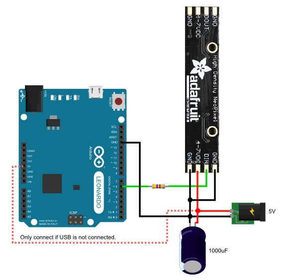

As I briefly mentioned earlier, Neopixels utilize a single-wire data format, meaning they only require a single data wire regardless if your strip has one module or one thousand modules. The only other connections required are 5V and GND connections. It is very important to remember that with each “pixel” you get three LEDs that are being driven. This means that Neopixel strips, and rings can draw a large amount of current. I find that on a standard Arduino board, only about 60 Neopixels can be driven before browning out the board, and that number diminishes by half, if the strip is set to display white at full brightness.
For this reason, I recommend driving your Neopixels with a separate power source such as a 5V 1A regulated source, or a 5V 2A wall transformer. You can also power the strip with a 4x AA battery box. Adafruit also recommends filtering the power input with a large capacitor, and limiting the current on the data line with a resistor. I find that this is usually not needed, but it will prevent a pixel from dying in the event you accidentally plug the strip in while the system is powered up.

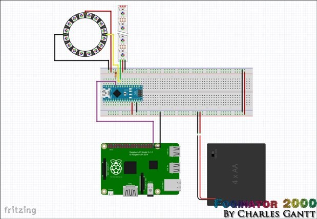

Wiring the Neopixels, Arduino Nano, and Raspberry Pi
Wiring up the Neopixels to the Arduino is fairly straightforward,and is as simple as following the diagram above. Note that I have connected the data-in line from both the Neopixel Ring and the Neopixel strip to the Arduino Nano’s digital pin 6. This allows me to drive both Neopixel devices with the same code. Also note that I have connected a 4X AA battery pack in the image for illustration purposes. As you will see later, I am using an LM805 VReg-based power supply in the physical application.
Connecting the Raspberry Pi to the Arduino is simple as well. Connect the Raspberry Pi’s GPIO Pin 21 to the Arduino Nano’s Digital Pin 8. Then connect one of the Raspberry Pi’s GND pins to the shared GND circuit between the Neopixels and Arduino Nano. It is very important that all of the ground’s in this circuit are connected together. Finally, a 10k Ohm resistor needs to be connected as a pulldown resistor on the Arduino’s Digital Pin 8. This will prevent any false triggers from happening.

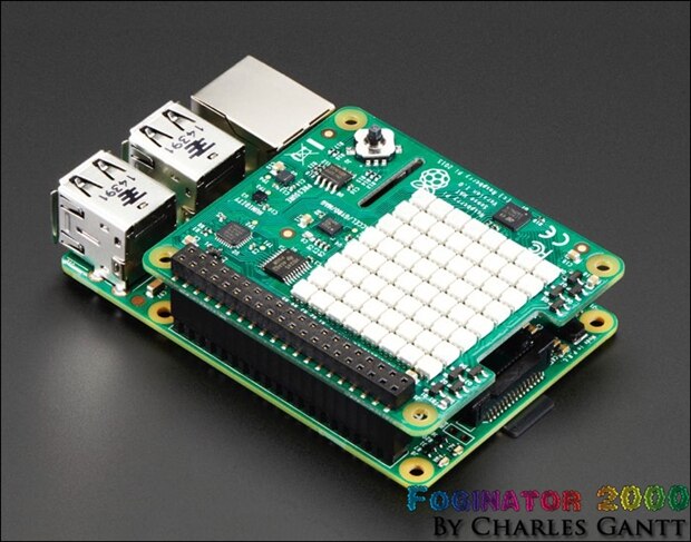

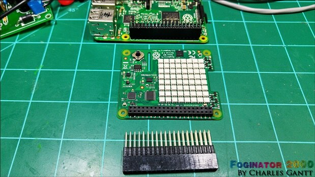

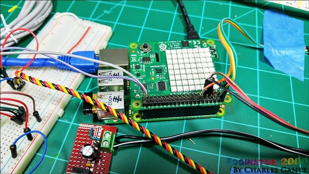

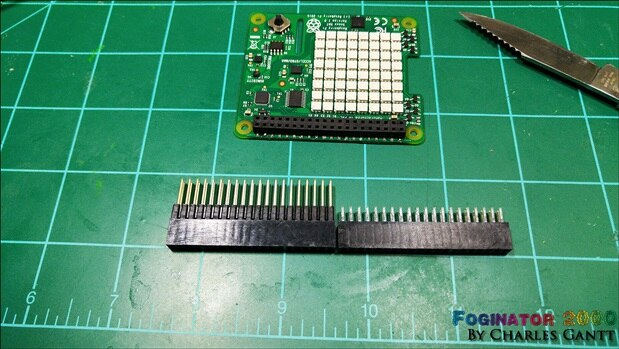

Since we are using the Raspberry Pi Sense Hat with our Raspberry Pi, we need to make some slight modifications to the Sense Hat before we can connect any jumper wires to the GPIO headers. As you can see in the image above, the header pins that come with the sense hat do not protrude past the black plastic bar on top of the sense hat.
Unfortunately figuring out how to get around this issue is not something that has been widely discussed anywhere on the internet. However, I did manage to find a post on the Astro Pi forums that mentioned buying some extra-long header pins from Adafruit. This is one of the reasons this post has been delayed for so long. As you can see in the image above, the extra-long pins from Adafruit are about 5mm longer than the ones that ship with the Sense Hat.

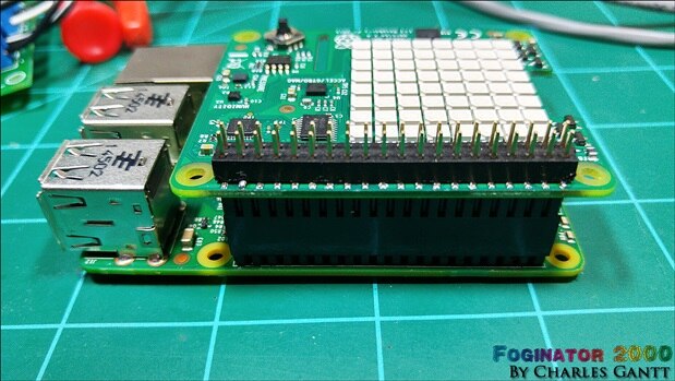

The first step in installing the new header pins is to gently pry the Sense Hat off of its existing header pins. The Sense Hat was designed with this in mind, and prying the existing header pin strip out is easy when done slowly and carefully with a small flat-blade screw driver. Once removed, you can simply slide the longer header pins into place.

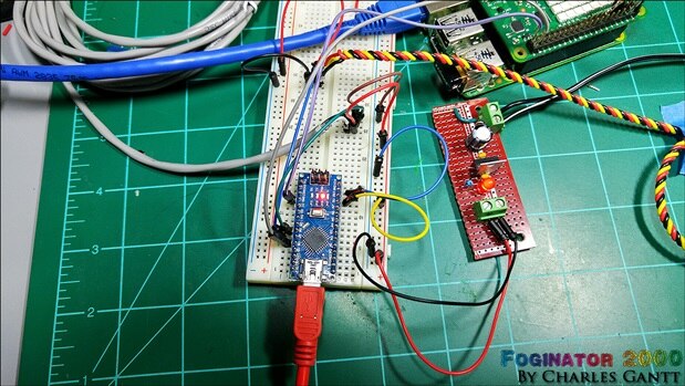

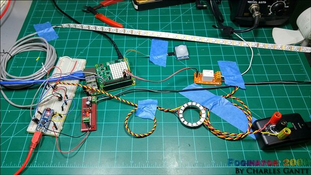

Now you are ready to hook up everything as per the instructions above. In the image below you can see how I have everything laid out. Note that for this portion of the project to work, you need to have followed all of the previous installment’s instructions as well.
It looks like a bit of a mess, but with everything laid out and taped down, I could easily troubleshoot any issues that arose.
Here you can see the connections made to the Raspberry Pi. Note that I have removed some of the plastic connectors from some of the jumper wires. The header pins only stick about 5mm above the surface of the black plastic bar, and some of my jumpers were having issues keeping a secure connection.
Here is a shot of how I have the Arduino Nano connected to the breadboard and wired up. Note that the grey wire is connected to the neopixel strip, and the twisted yellow, red, and black wires are connected to the neopixel ring. In this image, you can also see the LM7805-based 5V power supply I built. More on that later.

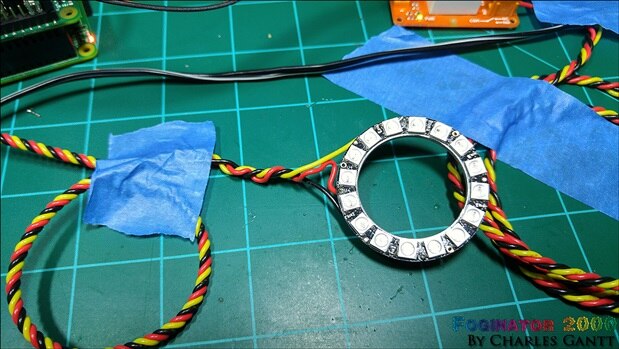

Finally, a shot of the NeoPixel ring wired up. Note that these rings do not come pre-wired, and you will need to solder wires to it.

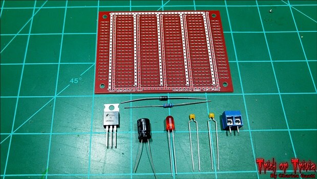

Building a 5V Regulated Power Supply
This is the same PSU that I built for my Trick or Trivia Halloween Candy Dispenser #004 - Building The Candy Dispenser & Servo Coding project, so I have re-used its images below. To build this PSU you will need the following components, as well as a soldering iron, flush cutters, and a 12-30V DC power source.

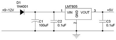

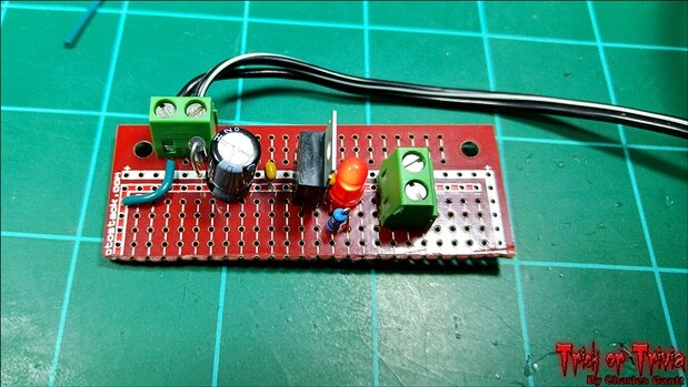

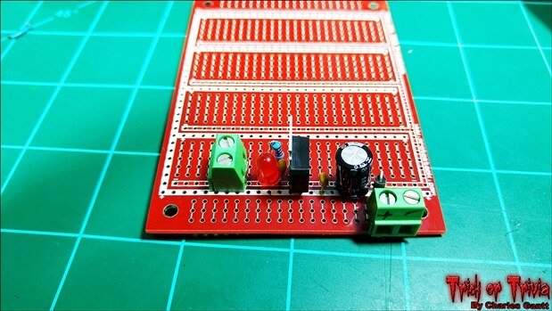

A 5V regulated power supply circuit is quite simple to build thanks to the fairly common LM7805 voltage regulator, and requires just five components to get up and running. A 100uF capacitor, two 0.1pF ceramic capacitors, a 1N004 diode, and the LM7805 regulator. I am adding two screw terminals, and an indicator LED to the mix. I want to design a pcb for this, but for now a piece of protoboard will work just fine.

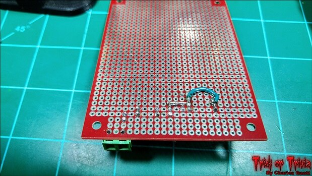

Following the schematic above, build the power supply and solder in each component. The protoboard I am using is different from the one listed above as I have a big supply of these from Protostack.com, so I just used one of mine.
With all of the components soldered together, I made the necessary jumps from each component to the next. I lucked out with the Protostack board as it has integrated power and ground rails. This cut down on the number of jumps I needed to make.
With everything soldered up, I trimmed the board down to reduce its size, and connected a 12v 1amp power source. The red LED lit up and I confirmed 5V out with a multimeter.
