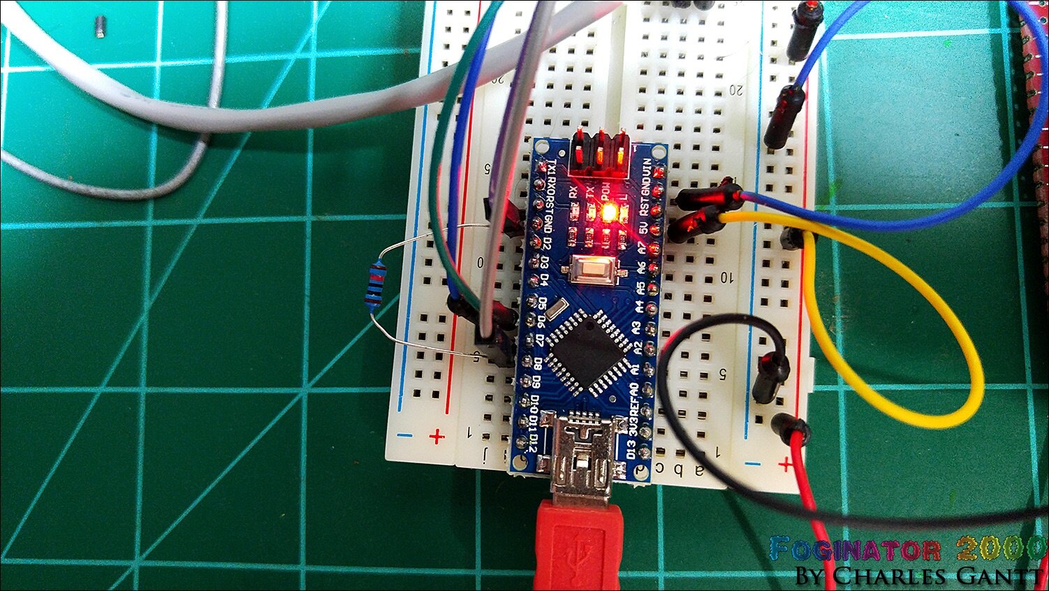

This is the main portion of what we need to move to a prototyping PCB. The Arduino Nano, a pulldown resistor, and the LED cable connections.
I am again using a Protostack protoboard as I have several laying around. You can use any prototyping board you would like though. I chose to only solder the pins that I was using as well as the 5V and GND pins.
Here you can see that I used jumper wires to connect the GND and 5V lines on the Arduino Nano to the GND and VCC rails on the prototyping board. That is why I love these little boards from Prototstack. They are laid out like a breadboard, with five of the holes connected, and the power rails encircling everything.
With the power connections made, I soldered in the Neopixel strip. I am not a fan of the microphone cable I used for the connection when soldering to these boards. Their holes are designed for smaller through hole pins, but with a little finesse it fits well. You will notice that I did not solder in the Neopixel ring. I think I killed it on accident, as I could not get it to light up at all.
