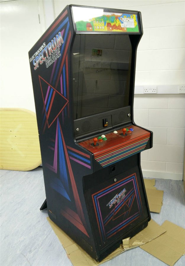

We've been cruelly teasing you all week about a project we're about to kick off here at element14, as we alluded to the brand new Raspberry Pi case we had delivered.
image image
image image
But you guys were too quick for us. Although there were a few wry suggestions about what was being delivered -- including a rather excellent notion about building a Raspberry Pi juke box (watch this space) -- most of you astute Pi eaters sussed out that we've bagged ourselves a classic, upright arcade cab that'll soon become the company's most effective time wasting tool to date.
Arcade Machine14
The facts are these:

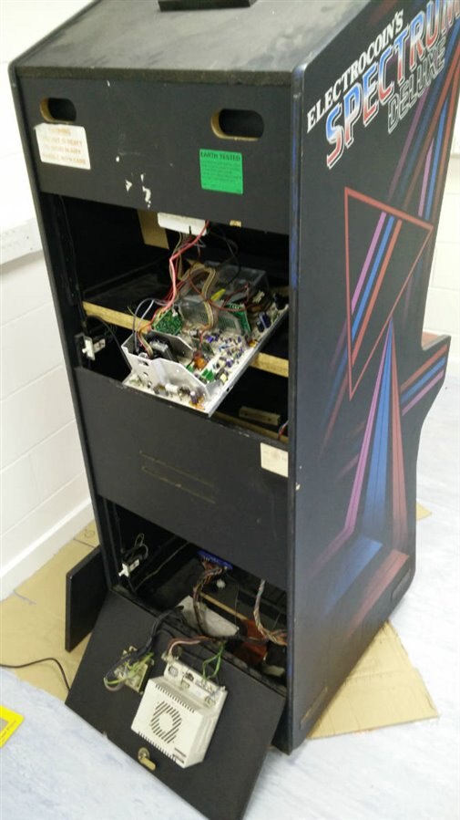

  • With your (not insignificant) assistance, we're going to strip out the cab and retrofit it with a Raspberry Pi.
  • The RPi will be used to emulate a bunch of classic video games.
  • The cab will be installed here in the element14 offices for the staff and visitors to play.
  • Any money collected by the cab will be given to a community-selected charity each month.
Great plan eh? But there's no shortage of work to be done before the pixels can be set free.
Retro Revival
There are a few factors we're endeavouring to accomplish in this project. Firstly, we want to keep the whole thing under the £500 mark, thereby making the build comparable to buying a contemporary games console. So anyone who builds along with us can divert any funds they might have allocated to an Xbox or PlayStation, and have themselves an arcade cab instead. It's a gift to yourself that keeps on giving.

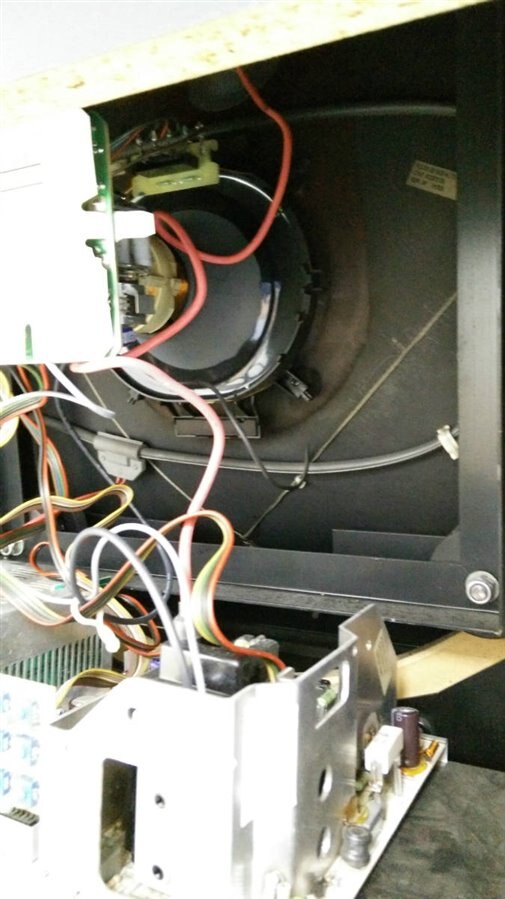

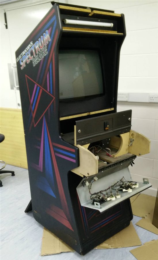

We also want to re-use as much of the cab as possible. It's got a power supply in there already, and it still has its old 15KHz arcade monitor, which you can't beat for that authentic look. Hooking it up to a Raspberry Pi isn't going to be any small task, of course, and we're not even sure if it's working right now.

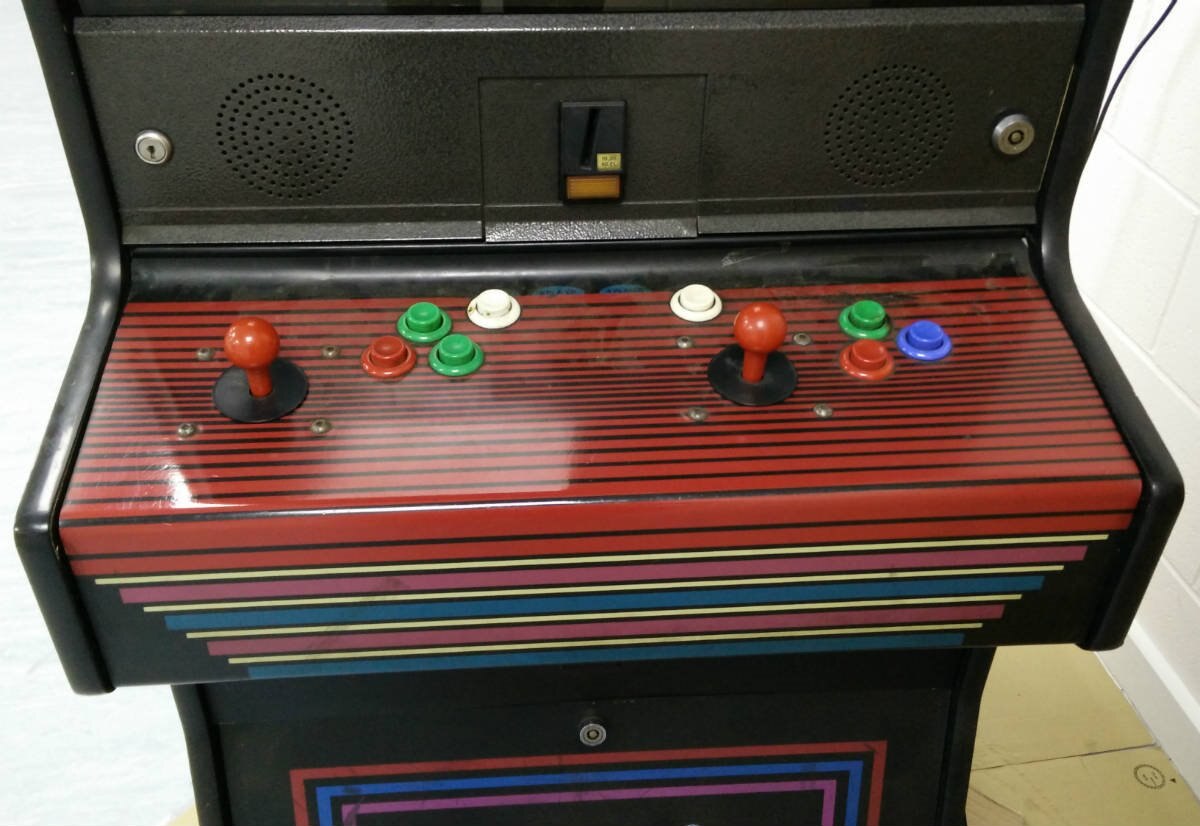

And then there's the controls. We'll need to interface the joysticks and buttons with the Raspberry Pi, which in itself isn't a particularly difficult task. At least, it wouldn't be, if the RPi had enough GPIO inputs for eight joystick directions (four for each stick), 12 game buttons, two game start buttons, a working coin mechanism, and however many controls we need to operate the OS front end and emulators. Hmm.
So we'll be calling on the element14 community for input and assistance at most every turn, and would love to hear any hints, tips or ideas you might have about putting together a Raspberry Pi arcade machine. In the meantime, we'll bring you regular blogs and discussions about how the project's going, and how you can help.
For now though, here's a look inside and outside the cabinet. I'll be downstairs, cleaning it for the first time in 30 years...

    IMO throw the main circuit board away, as well as the monitor. Get a cheap LCD and just use a Pi. You may be able to use the power supply but its overkill. Just my .02. Gut the whole thing and put a Pi…

    For completness though, typically the RGB signals and H/V sync are 1V ptp and about 50-75ohm impedence ish. the Monitor will be at best 640*500 or so lines in interlaced mode so quite low res for a PI but in line with many smaller LCD screens
  • Robert Peter Oakes
    Robert Peter Oakes over 10 years ago in reply to spannerspencer
    Yes, but I thought you where wanting to keep the monitor for accuracy and staying true to the origional, but really I agree with the others, replaceing it with a low cost HDMI 1080P screen or even 720P and your life will be so much easier as you may spend way too much time trying to interface it than it is worth, and the LCD screen will probably be no more $$$ than the interface hardware, though the aspect ratio may be off a bit from the original.
    Also dont forget the monitors in most of those arcade games are mounted in Portrate not landscape
    As for the switches, I also agree with the general opinion that it is also overkill to try to optimise the switches in a matrix, take a leaf from Ben Heck and his pinball machine projects and use a 8 bit to Serial convertor, you could use his interface exactly  the same way so nothing to really design either, just build one on vero board or get him to send you one image

    My answer is yes. I was just thinking that a bare LCD is too "modern" instead an old TV maybe the good compromise.

    Yep, you guys aren't wrong -- in many respects we're making it hard for ourselves using the old monitor image
    When we were shopping around for an old cab, 97% of them didn't have their original monitors, or if they did they were burnt to hell. But as this one happened to still have it, we thought it was worth a bit of effort to try and get some life from it before we scrapped it image
    But if it becomes a huge obstacle or winds up adding a load of money to the budget, it'll probably get replaced. Maybe an old TV would simplify things, while still giving it a more authentic look?
