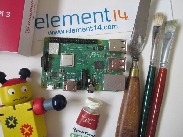

I'm going to be using a Raspberry Pi 3 B+ as part of the PiCasso Design Challenge
Here it is, along with some art materials

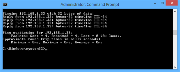

I then connected a laptop and the Pi to an old router (just so that there would be no connection to the internet whilst doing the initial 'fiddling about'). I couldn't find the IP address using the methods shabaz outlined, so I used the web interface to the router and found them (both the Pi and the laptop) listed in a convenient table.
That then allowed me to ping the board. Success! The pi is there and responding.

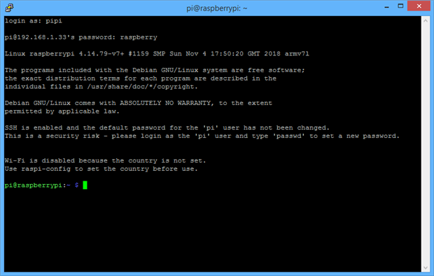

Finally, I ran up PuTTY, put in the IP address as the host, and then could talk to the Pi. Here's the screen after I logged in using the default user and password. I now have a board that I can experiment with. Next step is to read about the GPIO and how it gets controlled.
