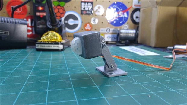

Finally, we need to attach the PIR Sensor to the top of the frame. To do this, I found a nice and compact PIR sensor case on Thingiverse, which I remixed, and designed a small extension arm for. Download it here. This is held together with M3 machine screws and nuts. To mount it to the top of the frame, I just used more small screws like I used on the corner brackets.
To finish up the PIR sensor mounting I needed to make up a cable that would connect it to the Raspberry Pi. Using a pin and crimp kit, I made the cable about three inches longer than it needed to be to add some strain-relief and prevent the cable from putting too much tension on the pins of the Pi.
