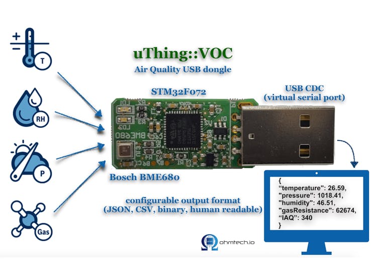

OhmTech's uThing::VOC USB air-quality sensor dongle provides a quick way of obtaining data from the Bosch Sensortec BME680 sensor module.
uThing::VOC air-quality sensor dongle
The STM32 MCU integrated in the USB dongle captures raw data from the sensor and uses the Bosch's proprietary Air Quality calculation algorithms to obtain equivalent air-quality (IAQ Index), temperature, relative humidity and atmospheric pressure values. These values are then output over a simple Virtual Serial Comm on the USB connector in different configurable formats (JSON, CSV, Human readable or binary).
The uThing::VOC can be configured for different output data rates and formats. By default the sensor data is output every 3 seconds in JSON format. We will use the default settings for this project, but they can be changed easily, check the datasheet for more information.

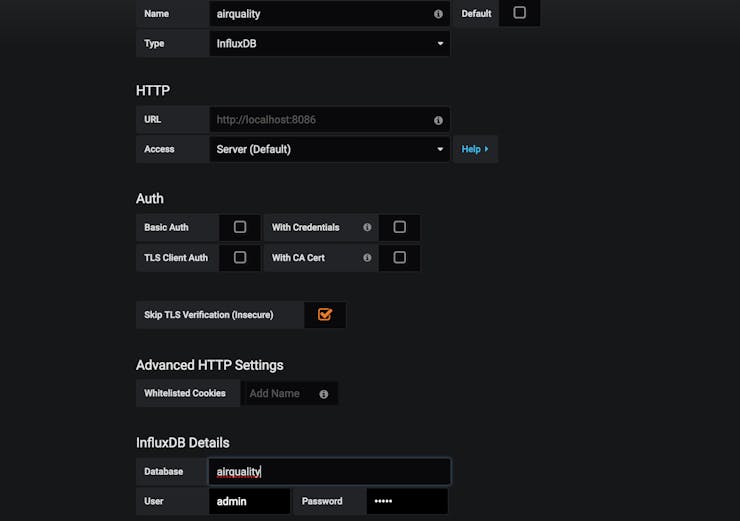

5) Configure a data source (local InfluxDB database airquality) with the following parameters:
Grafana: adding a new data-source
  • Name: airqualityMonitor
  • Type: InfluxDB
  • URL: http://localhost:8086
  • Skip TLS verification
  • Database: airquality
  • User identification: not needed since it’s disabled on theInflux configuration.
6) Import the demo dashboard:“Upload json file” (’airqualitymonitoringDashboard.json’)
